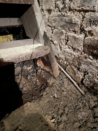

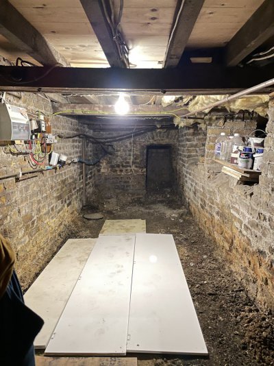

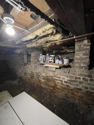

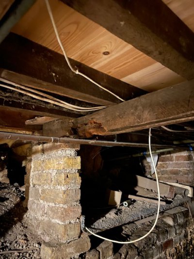

I've recently moved into a ca.1900 bayfronted victorian house, which has a small (ex coal) cellar. It is accessed under the staircase and runs below the hallway. It's ca 5.5m x 2m and only half height, so one needs to duck/crouch down there. There is currently not any flooring, so the earth/clay the house sits on is fully exposed. I've attached a few pictures to give you an idea of what I am dealing with. I've put down some old wardrobe door panels to walk on to prevent the soil/mud being spread around the house. This cellar was flooded due to a broken pipe in 2021, but this has been fixed since and no further issues.

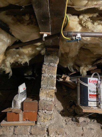

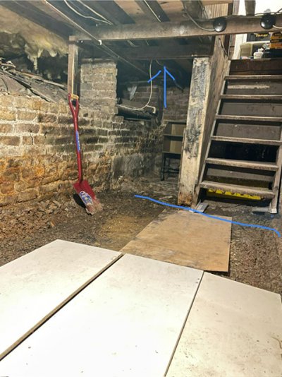

My issue is that the joist (indicated by the blue arrow) seems to be giving in. I have't noticed any sagging floor and the damage does not look recent, but I suspect it could be from the supporting pillar and the stair case suffering some wet rot as they basically sit almost directly on the damp clay. As the surveyor did not seem worried and I do see any sagging, I am less worried about the structural integrity but more so by the fact that a water and gas copper pipe run underneath it. In case the joist comes lose it might hit the copper pipes.
What would be the recommended course if action here? I would think the joist might need sistering, with possible correction to the sleeper wall. Furthermore, I would be inclined to replace the staircase and the pillar, perhaps with a concrete base or a slab so it is somewhat shielded from the damp soil?
Would this be a job for a carpenter/woodwork or general builder? If anyone has any recommendations of an experienced tradesperson/company serving North London, feel free to share.
