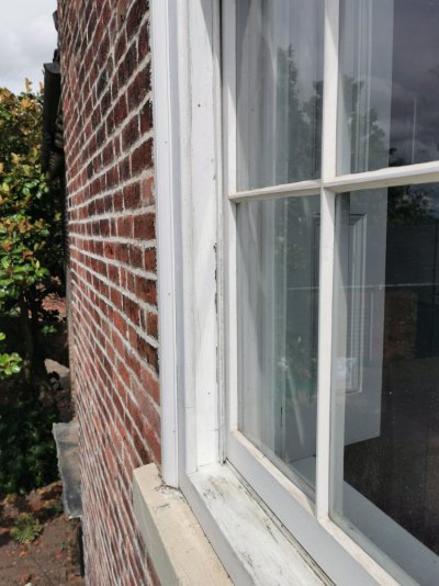

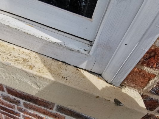

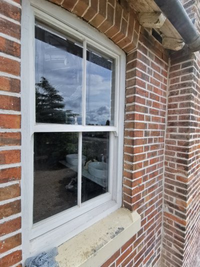

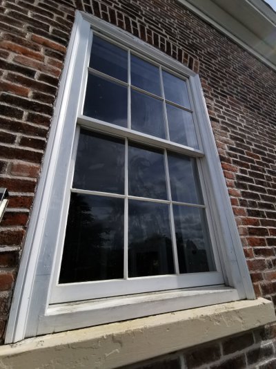

It's 5 years since we restored the sash windows on our Georgian house following the guidance on this site from Feltwell and others. All windows were taken back to bare wood. Accoya sills were fitted to nearly all with Repair care resin used for the repair work. A small number of replacement sashes were fitted. We fitted 3 new hardwood sash windows. Bedec MSP was the chosen paint.
As part of a larger project, I feel we didn't give the job quite as much care and attention as we might if it was just a one off with more time to devote. That said it took me and our joiner approximately 5 days to repair and repaint each window.
5 years on and I think I need to get the paint out... The Bedec MSP has been OK, no complaints but I wonder how others have fared with this paint. Would you use it again?
I've attached a few photos showing the current condition of a couple of windows. As I've not done any repainting since the renovation, I wonder what you would advise... A quick rub down and recoat without taking anything apart? Extra coats on the sills look necessary.
What about any cracks? The repair care has cracked in places and I wonder whether I need to do anything other than just painting?
I never really did anything to fill the gap between the brickwork and the recessed sash windows. Most of the windows were more flush with the brickwork but some newer additions sat behind the outer skin of bricks. I must admit to using some caulk on some and lime mortar for the wider gaps. I never finished the job and would be keen to know the best approach.
Thanks in advance for any guidance offered.
