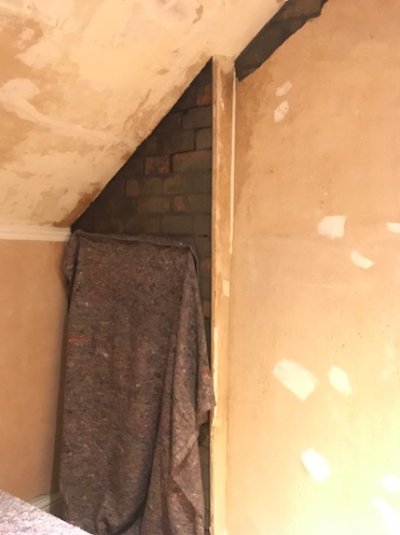

I'd be grateful for advice on exactly what is needed successfully to add lime plaster to an internal brick wall.
A chimney breast in our attic room had a small, persistent patch of damp, probably through the chimney being sealed. We've removed the old plaster (a mix of lime at the top and plasterboard lower down where the fireplace was covered over), replaced the old flashings, vented the chimney and are now happy that the problem is solved and the wall is dry. It is inside the house, but an external wall (if that makes sense), with brick on the inside and stone outside. The house is Edwardian. The rest of the walls are covered in an old, slightly rough lime plaster (maybe a scratch coat?).
Our builders have agreed to replaster the chimney breast with lime, but I am not entirely confident they will follow good practice - even if I knew what that was! So I'm hoping for some expert advice - for instance, Is there anything they should use / avoid using before applying the lime, what sort of lime should they use, how many coats might be suitable, and any other questions I don't even know to ask...
I have a meeting with the head honcho on Thursday to agree the work and want to make sure I know what to agree to / query / refuse.
Advice much appreciated!
