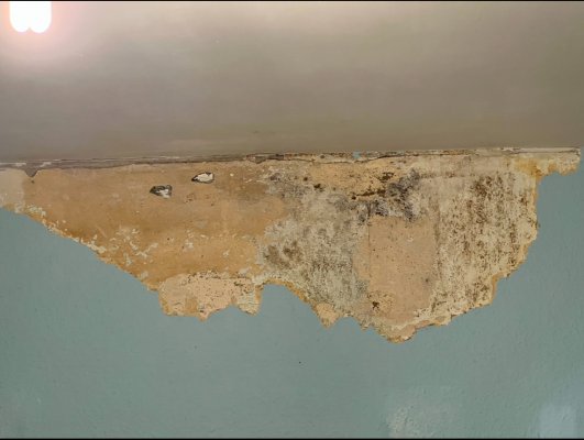

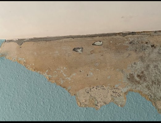

I have a chimney breast that revealed a spot of damp after the heavy rains in September. I peeled the wallpaper back to the lime plaster to allow it to dry. I thought there was black mould over it, but after touching it, it smudges. I think it's soot, but it might be a type of black mould that smudges. it felt a tiny bit damp. Anyways, it's been about 2 months now since and I've been letting it dry all this time. The room's humidity has remained about 50-60%.
I will still give it more time to dry, but back in September I had my roofer take a look as I thought the cause was down to a leak. He wasn't sure it was but he noted the felt wasn't stacked against the chimney stack quite right and redid this for us and put the lead flashing back "properly". I can't remember exactly what he did, but he said that it could be due to heavy rain going over the threshold of the lead flashing and that might have been causing it. I decided to go with a repair here just in case, in preparation for the winter. All has been fine in the area since, but we haven't had heavy rain since then.
I have been in the loft this weekend and checked the same chimney breast area that extends into the loft here, before it becomes the chimney stack. It didn't feel damp or anything and looked fine to my unprofessional eye. The bitumen and surrounding roof area looks absolutely fine. I think the cause of the damp spot on the chimney breast may actually be down to condensation within the chimney breast - probably due to salts.
My best bet is to just let it dry out further with the aim of redecorating this room in the Spring. In the meantime, I am thinking about these possible salts. I don't think the previous owner took care of the chimney and never had it "cleaned" (swept?). Personally, I have never ever hired a chimney sweep before (I didn't even know it was a thing before buying my period property.

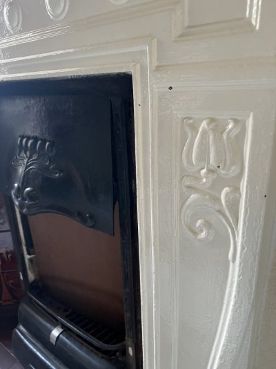

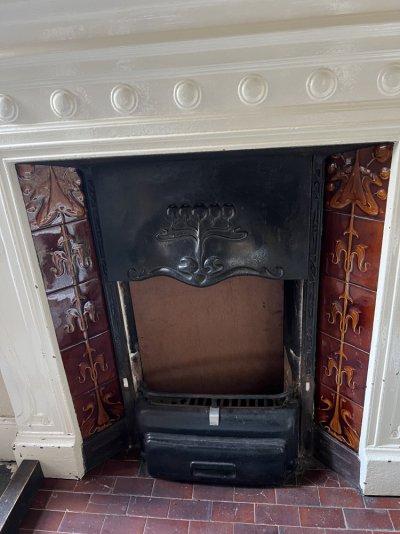

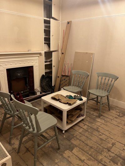

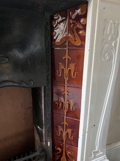

In this partiuclar room with the damp spot, it's a bedroom. Below, the chimney breast extends into the dining room. There is a "traditional" fireplace there, but it is unused. I disconnected the gas from it when we moved in. I think we will probably use it as a woodburning chimney in the future, once I figure out how to restore it or anything else I need to do. I've attached some photos incase it's helpful.
