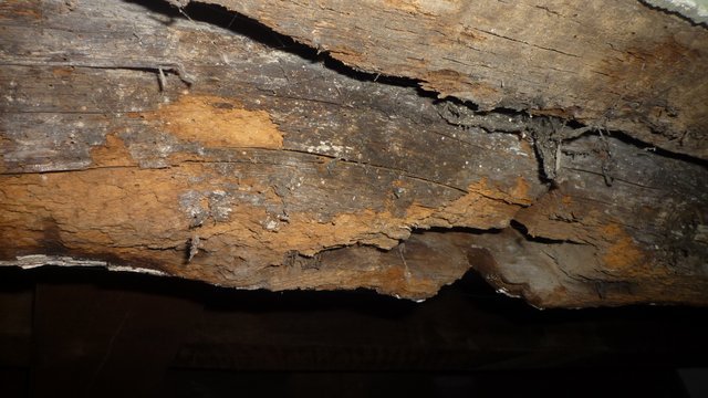

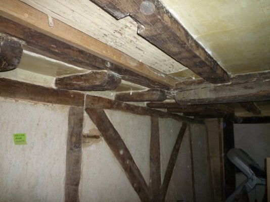

Probably no need for immediate panic. However, the situation needs to be assessed by someone who is properly qualified. Either a very good builder who is familiar with this type of building or a structural engineer likewise with the correct sort of experience. As you already realise the first step will be to remove the cosmetic boxing.
