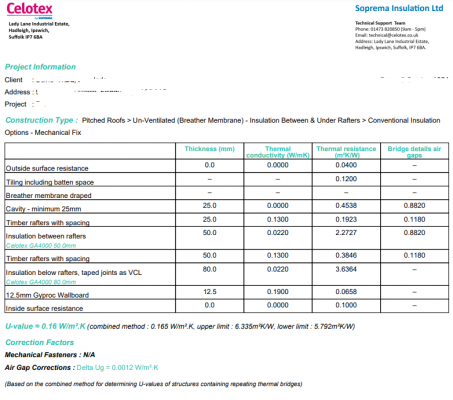

Who can make head or tale of this then?! I'm sure it's just me being thick but I'm not understanding the "timber rafters with spacing" sections and how this applies practically.
Its a calculation for insulating the pitched roof space in my house, ready to make them in to usable rooms. Roof construction is tiled, breather membrane. I spent ages considering sheepswool and hemp batts etx but unfortunately it purely comes down to price and head space!!
My rafters are 75mm deep.
Any help would be great, especially drawings for a simpleton like myself!!
