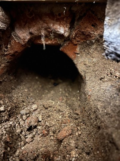

We are repairing some rotten joist ends on suspended timber floor over earth.
We have freed up debris and damp earth bridging sleeper walls & cleared air bricks/vents to outside.

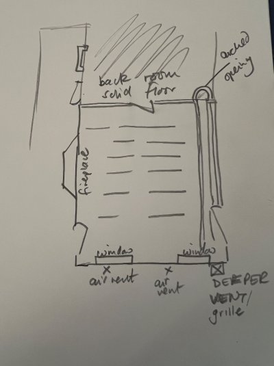

One of the 3 air bricks was at a lower level - about 150mm & sure enough we’ve found a brick built channel running back of house to front. It was filled with old & damp earth & brick rubble - now cleared. Old pitch (?) floor of channel in tact in some places.
The end is arched and runs under the next room floor - fully concreted eons ago.
Any thoughts on its age, use & what to do about the part that seems to run under the adjacent room with solid floor?
