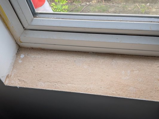

On the inside of the same window, we've had the entire wall around the window stripped back to brick and lime plastered (see attached picture).
So am wondering how best to fix a (solid) Oak window board down? I assume slathering a load of "modern" grab adhesive (+ screwing it down) will counteract the breathability of the lime plaster? So am ideally looking for a breathable fixing solution with some kind of draught proofing if possible - if I never find the cause of the draught - is laying a very thin 1-2mm wool/felt-like material on top of the plaster/under the board and screwing down an option???
