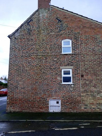

Hi all,
First post in this forum, Ive just moved into an 1812 cottage in north Lincolnshire, loving the Pheasants, Peacocks and Deers that like to keep me awake at night, but i digress.

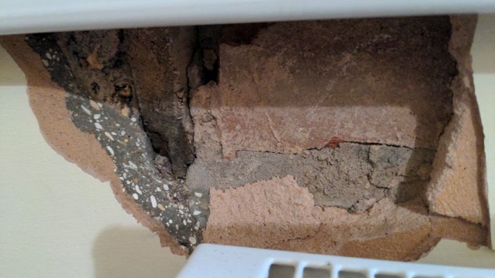

This house was an ex council house and has had alot of lovely features covered up which are causing issues, my main concern at the moment is one of the exterior brick walls feels cold on the inside and looks wet on the bricks outside, now someone in the past has covered the lime pointing up with a cement mortar, this isnt a particular good job and shouldnt be too hard to remove, the internal wall (full length of house, different rooms) have been plastered in gypsum with something under the plaster which has what looks like lime clumps in it, i dont think its right and i understand these materials do not breathe (obviously not the lime), the bedroom is currently between 8 and 12 degrees c, 86 % humidity, with the windows constantly cracked to deal with the moisture that me and my wife breathe out in the night
I suppose im just wanting some confirmation by people that have has the same issue and removed the gypsum based product and replaced with lime, that it does actually work as its a lot of time and money
