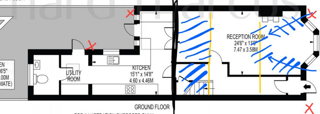

1) Damp. The house smelt very damp/mouldy/musty when we got the keys. It had been raining for a few days. I discovered a floor air vent in the living room and sticking my phone down into the subfloor void to video, there are large areas of wet/damp topsoil in the void and it smells absolutely awful down there.
This damp smell is pretty pervasive through the entire ground floor and first floor when it rains even a little.

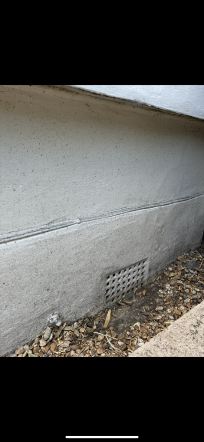

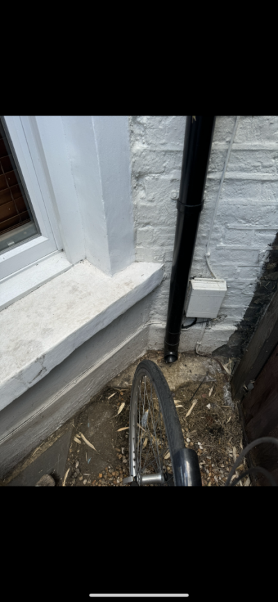

From what feels like hours of reading these forums, I understand damp is an extremely common issue and improving ventilation is useful. There are 3 airbricks to the front of the original property which are working, but they are only just above the front garden level. The front garden is also level with the interior house, if not slightly higher, which I understand isn’t good.
It looks like there is a slate damp proof course running along some of the foundations, but I don’t know if it actually runs throughout every wall. Concrete based extension at the rear also has airbricks but for some reason has a weird stale smell which is different to main foundation/void smell.

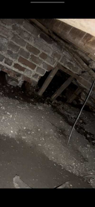

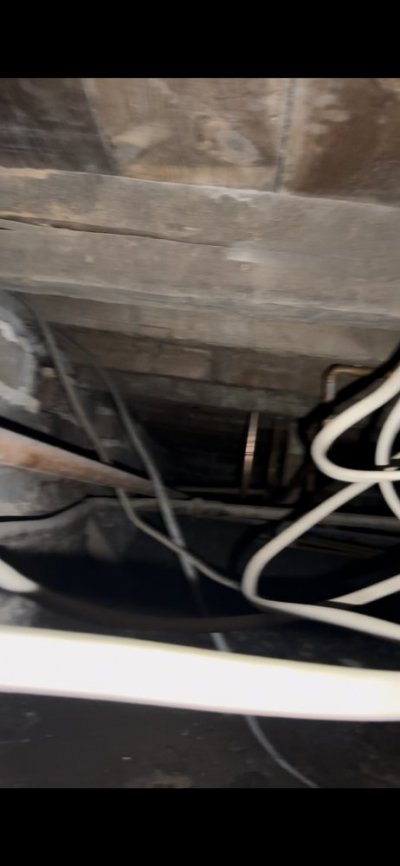

2) Joists/sleeper walls. The other problem we noticed in the video is that both of the sleeper walls are cracked, downright broken, and resting on timber struts. This concerns me because it looks like the wooden joists in the living room are barely even being supported by the sleeper wall - even where the wall isn't cracked, the joists seem to be ‘floating’ above the wall because the piece of wood on top of the sleeper wall to connect with the joists doesn’t run the entire width of the wall.
It freaks me out every time I put in heavy furniture on the living room floor because the floorboards are springy/bouncy in feel. You can actually see the floorboards give in underfoot whenever someone heavy walks around.
I’m worried theres a combination unsupported joists plus potentially rotting joists problem thats causing the floorboards to be not solid.

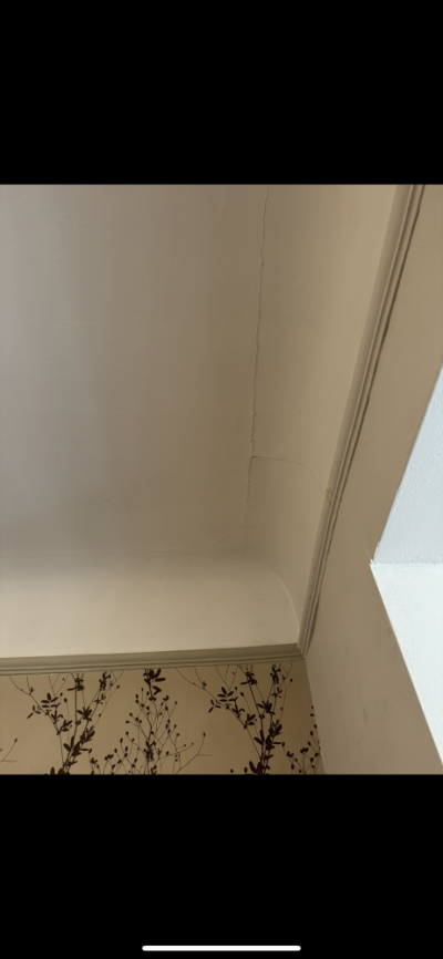

3) Foundation instability. Many of the interior walls have long vertical cracks with spiderwebbing cracks in the corners of the ceilings, as well as horizontal cracks running along the ceilings. The surveyor said they weren’t a problem because they were not mirrored on the exterior brick wall - but I have noticed a long hairline crack in the first floor bathroom, which actually goes through to the exterior brick too. I understand this is an old property, but my relative also has a Victorian terrace and they have no interior cracks.
