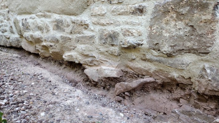

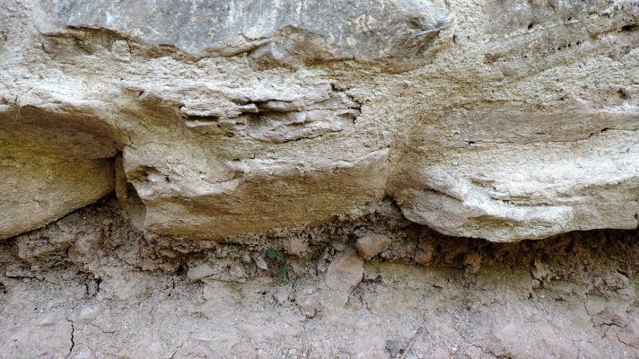

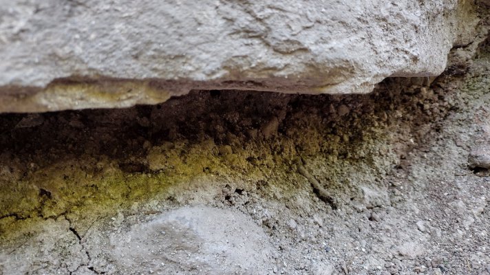

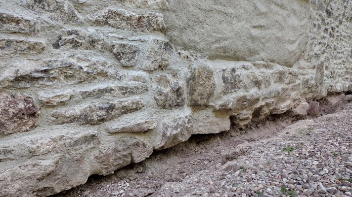

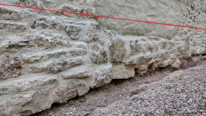

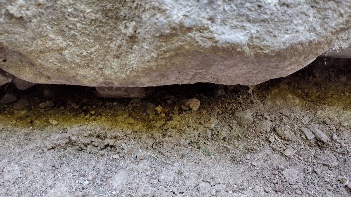

We had the roughcast render hacked off the stone wall of our house, and the pointing replaced with lime mortar. There are no foundations. At the time, I pulled back the gravel at the footings of the wall, creating a bit of a trench. There's hard compacted soil beneath the bottom stones. But in some places, there's quite a deep void until you get to the soil (a horizontal void). In the "worse" places, I can get my hand and wrist in there to around halfway along my forearm.
Should I look to fill these horizontal voids before all the gravel gets pushed back into place? Or is it enough to just let the gravel fill them? If I do fill them, what would be best to use? I was thinking NHL lime (3.5?) but also using stones under there to help bind the mortar and to prevent having to use too much of it. But that's a total guess and I'm all ears on what I should use, if indeed anything.
Aside from doing what's right for the building, it does seem that mice are quite keen to scurry their way into the wall (and house) through these deep voids. I've got them blocked with plastic at the moment to stop that. I'd want to make sure whatever I do stops mice getting in.
Pics below, showing the deepest and shallowest sections. And just to be clear, when the gravel is put back to how it was, these voids would be below ground level.
