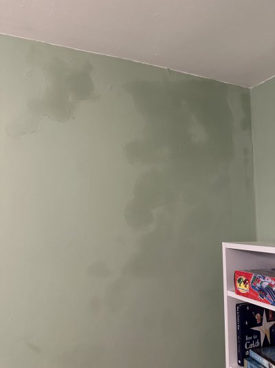

M Mr_Green Member Messages 30 Location Bath Dec 5, 2023 #1 Where does one start to diagnose this properly? Just had the chimney repointed as was told by a roofer that was the cause, it’s still growing a little after a downpour. Top floor of house to the right of a chimney stack. Flashing is apparently ok. Get another few roofers around I guess.
malcolm & Clementine the cat Messages 1,870 Location Bedfordshire Dec 5, 2023 #2 Post some photos of the same wall from outside. Normally it'll be something like a gutter overflowing over a wall that can let water in but not out.
A a twig Moderator Messages 2,537 Dec 5, 2023 #4 Camera drones are under £50 now, cheaper than a ladder / scaffold
M Mr_Green Member Messages 30 Location Bath Dec 5, 2023 #5 Those nasty cheap ones would end up there for good. Did have a roofer pop by, got his stuck. Didn't see him again. I'll get that one going.
