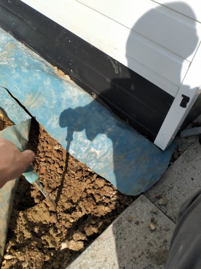

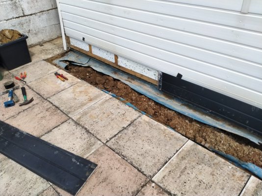

It's behind the render, which is behind the cladding and did stretch all the way under the patio, until I cut it to address the grade. The first row of slabs were sloping towards the house. One end of the blue stuff was letting water in where it had been cut previously. Any advice on how to deal with this would be gratefully accepted. I'm thinking to dig down and fill with gravel to give the water somewhere to go. It was pooling up against the house.would.i need to replace this blue stuff or can I just let water drain into the proposed gravel channel. House is around 1920's with a remodel roughly 20 years ago. Thanks!
