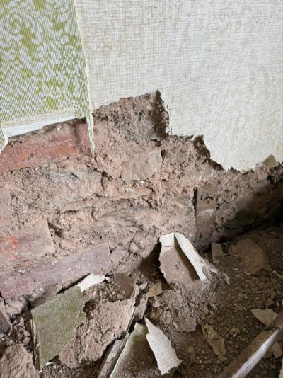

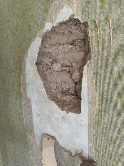

I've posted here previously but have an update now i have more access to the property. Its an 1860's sandstone property with obviously very thick walls. The property has had next to no work done on it for the last 60 odd years so will need a full replumb and rewire. It has no insulation and has signs of historic damp but doesn't seem to have many issues currently (It was vacant for roughly 9 months before we acquired the property) . I've taken back some of the internal plaster and it is roughly 1 inch thick and applied directly to the stone. It appears to have used a form of horsehair, and came off very easily. The stone underneath felt dry, but i might also try getting back to the stone in other areas.
So my question:
A. Would you suggest leaving the plaster as it stands, with the view to potentially apply a form of insulation on top (for example aerogel as its thin and can improve the Uvalue by a large margin). I think the amount of space that would be lost in the room is negligible in comparison to the time, effort and money required to get it back to stone. I also don't know whether i would create more issues by removing the plaster!
B. Remove all of the current lime plaster so there is a clean slate upon which to redo the services and plaster. Potentially longer process but you then know its all up to date and know there's no nasty stuff behind your walls that may cause issues in the future.
C. Dont do any insulation but merely chase the walls for the cabling and then redecorate.
If you need any more information then plaese ask. All suggestions are welcome, many thanks!
C. Not bother touching the walls at all as the stone is thick, and simply chase out some of the existing plaster for cabling and then re plaster with lime over those areas.
Photos attached below, any and all suggestions are appreciated and if you need further information then please ask.
