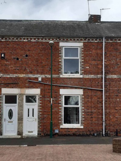

We live in an 1890s mid terrace, and the upvc windows are blown and need replacing. The question is... what with? I'm fairly sure these windows will have been put in during "renovations" in the 80s (themselves the cause of most of our problems). Originally I think these would have been box sash windows, it makes sense with the tall openings (roughly 1160 x 2040) and I've seen evidence that they might have actually bricked up the reveals on the inside to make them flush. None remain in the neighborhood though, most everyone has similar upvc casements with various distributions of the sashes, though equal top and bottom is most common. A couple of people have enormous Scottish/European style tilt and turn windows.
I've never been fond of these windows, they're hard to reach, the panes are still fairly large and heavy which the hinges seem to struggle with and can't maintain a good seal, and I find the plastic quite ugly to be honest. But thinking about it, I'm really not sure how much we can change them. The house fronts directly onto a pedestrianised street, which rules out any side opening windows as they'd stick out into the path (and let people just hop in if the windows were open). At least going to equal sashes would make them easier to reach. As I see it we have three options.
A) Timber casements, top opening, equal top and bottom. Easy, gets the job done, probably still looks nicer than anything anyone else has.
B) Timber or upvc sash windows with a spiral balance, could fit in the opening as it is but have to deal with ongoing maintenance.
C) New box sashes with weights. Would have to hack out the reveals, probably install a new lintel inside, fit the windows and make good. Realistically, too much time, disruption and cost. But would probably last another 100 years.
What would you do?
