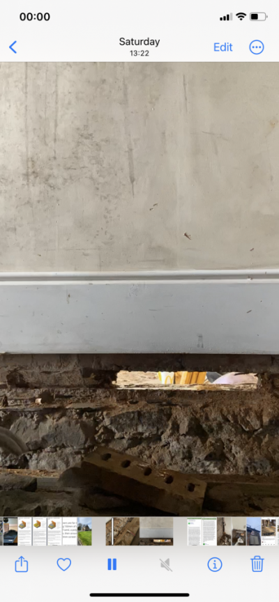

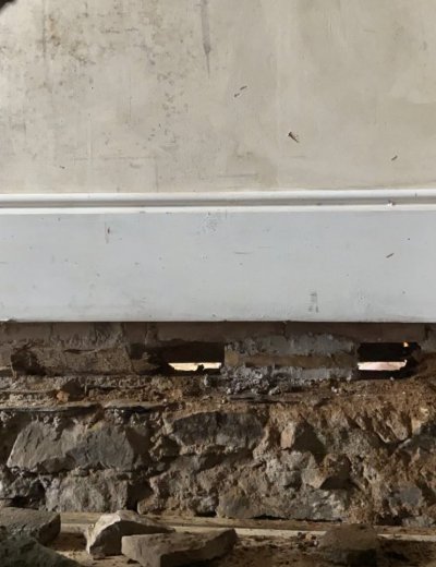

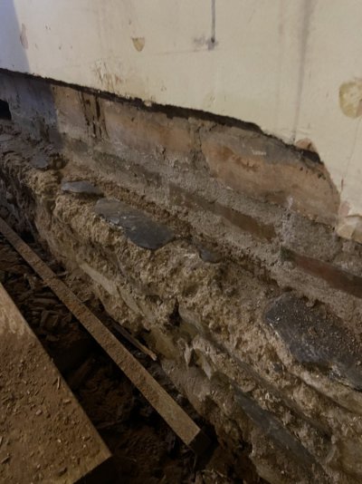

I’m in the process of restoring a 1900 house and I’ve come across a few problems. My floors are a mix of concrete & suspended timber ,
Floors are dug up now for 4 months .

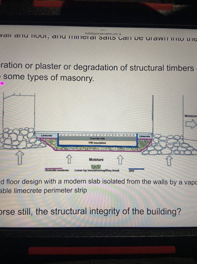

Q1 I am considering putting in glass insulation with LimeCrete is it worth the expense & the effort (100sqm) should I do concrete or some sort of hybrid floors .
(My worry with concrete is, the problem below will only get worse .

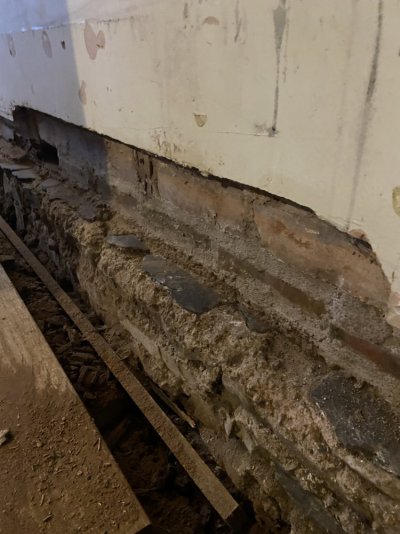

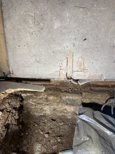

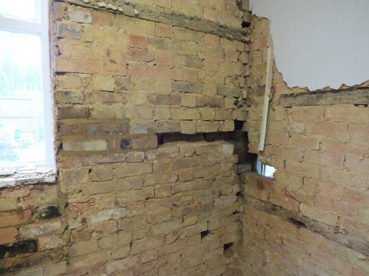

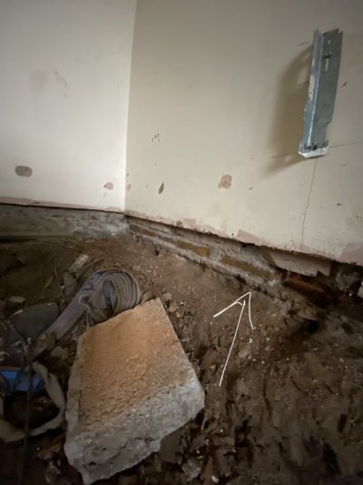

my internal walls are timber stud , infilled with red brick , problem is timber at base 4”x2 but has narrow in places , it’s wet , soft & rotten in places
Q2 can I cut out sections and fill in with red bricks with lime
Or should I replace with timber ?
Thanks Mike
I'm a little pressed for time at present so please forgive the brevity.
In your shoes I would be reluctant to use concrete in those floors and would err toward a limecrete solution as this would be less likely to introduce or induce new issues with damp in the short term and perhaps differential movement in the more distant future.
The rotting timbers need to be dealt with and the brickwork stabilised asap. Your choice is really whether to apply a short term fix that gets the house through the next few years or a repair that gets it through decades. Come what may you need to get the rotten timber out and new support in place for the brickwork above as a priority and I would use bricks for the job rather than inserting new wood.
BTW You're right to use lime mortars in all the repair work - provided the old mortar is lime based. Using OPCs to repair lime mortars in walls is a particularly bad idea.
