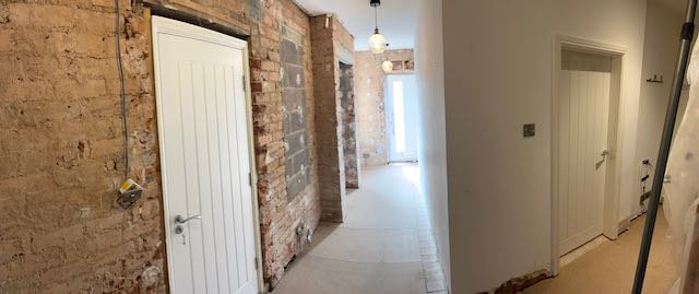

I'm planning on tackling my hallway which is back to brick. My plan is to button out to 50mm depth and add 50mm sheepswool insulation (except windows and door opening) then place 25mm wood wool on top and lime plaster.
After issues with dot and dab before and condensation related problems I'm keen to take a different approach. Does the above seem a fairly safe bet for moisture management and provide reasonable insulation . Any detailing I should be aware of?
The dot and dab before was about 7cm in depth in places so not too concerned about loss of space. The wall is a cavity wall.
