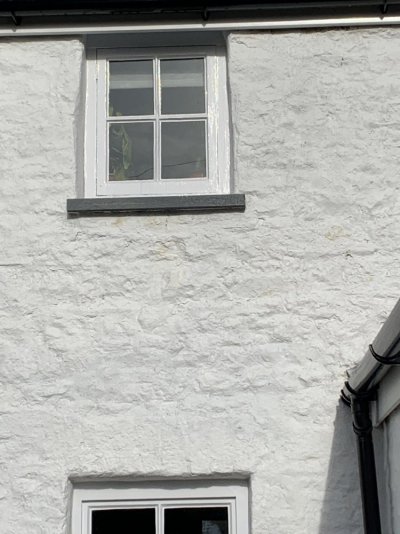

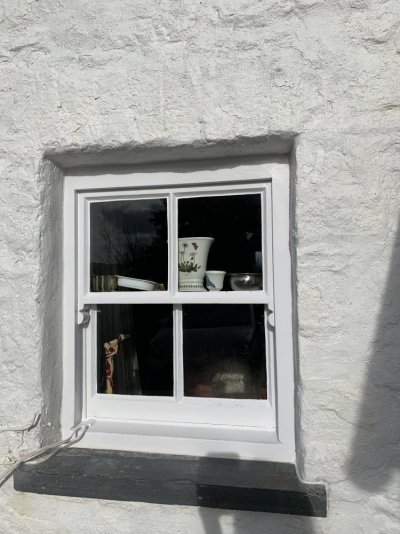

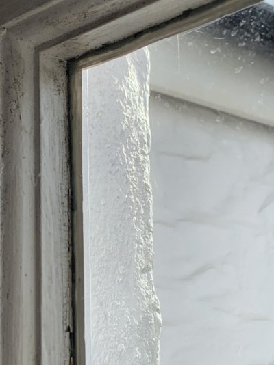

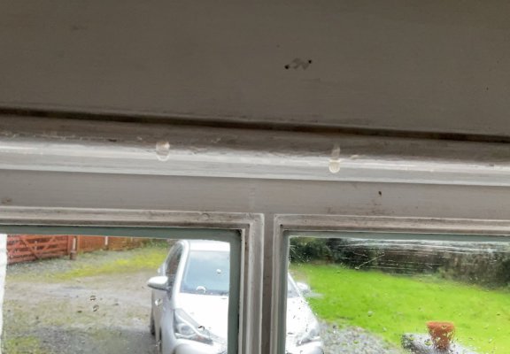

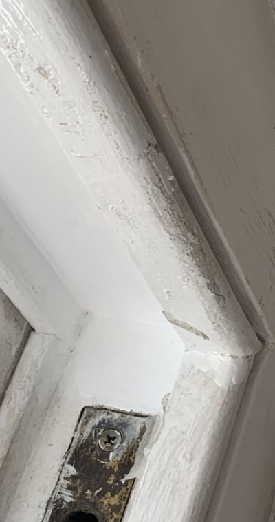

I had my wooden sash windows looked at resealed with chalk and filled but still I am getting a leak in the front room window . The person who overhauled my windows did the best possible job with the money I had . We just can’t work out where the water is getting in from and I have asked several tradespeople .please see attached video any help would be appreciated.
