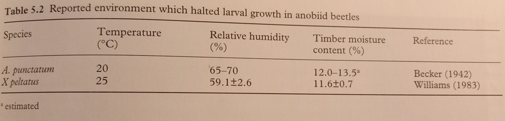

The responses to Zebra's question do seem to me to have slightly but significantly moved the goal posts.
We used to be rather glibly told that "woodworm doesn't like dry wood - all you need to do is cure the damp and the beetles will go away".
Now it seems that "dry" really means very dry, so dry that it is hard to achieve especially in an older house, and in any case there could well be micro-climates close to or actually inside infected woodwork which are less dry than you might assume.
