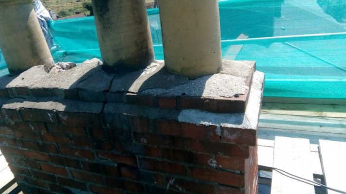

Pics of the story of our chimney on our mid terrace Victorian property. We knew the chimney was ropey (you could put your arm directly into each of the 4 flues in the loft where the mortar had been washed away) so as we were going to strip the cement from the front and re-do in lime we got the scaffold extended and the old chimney taken down.
The builder went up there to start taking it down and relayed the story to me the following day. "Took me bolster and hammer. Didn't need either of em"

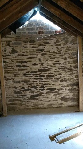

He took the whole lot down by hand, just picking the bricks off one by one, ended up taking the chimney down several feet into the loft until he found good stone to work off, re-laid the stone and re-pointed the wall then built a base of small blocks to get a platform to build off.

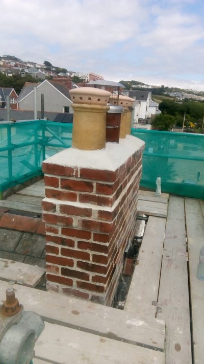

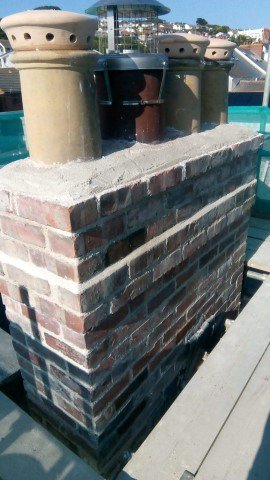

He then rebuilt the chimney stack using a mix of original bricks on the lower part and re-claims where it steps out (to hide the slight difference in brick colours)

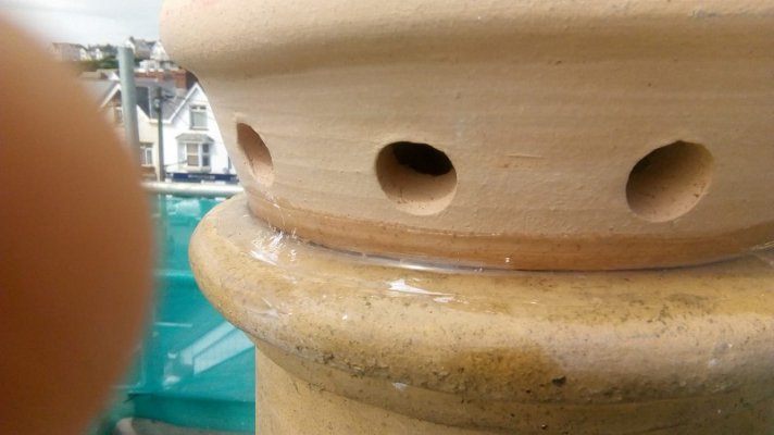

Got to say I am pleased with the end result. One more coat of lime on the flaunching is needed, waiting for a break in the weather.
