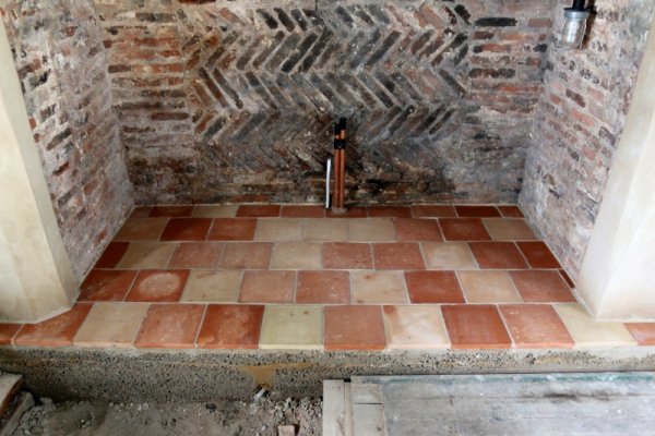

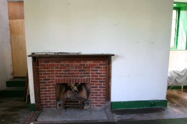

Yes, something of a surprise considering we started with this . . . .
We were pretty sure there was a far larger fireplace behind it and it turned out there were three different ones before we got back to the original fireplace. Although the above fireplace was built with horrible hard cement and was a pig to remove, the earlier ones were constructed from very soft lime mortar and could be deconstructed pretty much by hand using only a pry bar to loosen up the brickwork. The end result was that the original fireplace brickwork shown in the first photo was completely undamaged. In fact, the only thing we did was to brush down the brickwork and didn't even bother with any repointing, so what you see is exactly as it was bricked up a few hundred years ago.

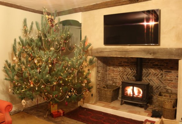

This was the end result (the Christmas tree gives away the completion deadline - a fairly common one I suspect

Wow that is great find considering what you started with Flyfisher. Lovely brickwork.

Yes, a surprising and welcome original find. We also had a very similar fireplace at the other end of the house, this time with a clearly visible original bressumer, so we were very optimistic about finding something similar. Alas, when opened up we discovered that the rear of the fireplace/stack had been repaired/rebuilt, presumably from the outside, with horribly hard LBC fletton bricks and strong cement mortar. Because the work was done from the outside, the inside finish was very rough indeed and it was a horrible job to chisel off the brickwork to an approximation of a flat surface. Because of this, there is no intention to leave the brickwork exposed and it will be lime-rendered before a similar stove is fitted.
As for the fireplace being too large and limiting the heat output into the room, that's not something we've found to be a problem. The chimney itself is blocked off with a register plate so there is little or no heat loss up the chimney (other than the unavoidable loss up the stove flue of course) and the heat from the stove seems to radiate and convect into the room well enough. After all, if it cannot escape up the chimney the only other place is into the room. We also have one of those heat-driven fans when the stove is in use, which is supposed to blow warm air out into the room. I'm not entirely convinced it's particularly effective as it seems to make little difference if we use it or not, though it's a quirky thing to have as a talking point for house guests who have never seen one before.
