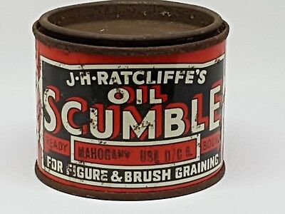

er. Varnish is, basically, boiled linseed oil with driers... ok, was.
you need this...
https://www.decoratingdirect.co.uk/viewprod/r/RATOS/
I was going to say, dont get Polyvine stuff... apparently JH is no more and its all polyvine.
Anyway. The JH stuff was the OG, as the kids say. Used it at college, did a fantastic marbled table for my Mum.
Then, in my ignorance decided I didnt need to buy it to do some oak graining in a famous church, because I would bodge it with some floor finish and some colourisers. I didnt.
Graining takes skill. I was lucky to see one of the UK's finest at work. Maybanks Snr, doing the ceilings in Palace of Westminster. His tower fell over narrowly missing me and causing me to call the London air ambulance to Parliament. But I digress.
Buy the traditional oil based scumble glaze (longer open time) you can have my turkey feather, flogger and badger softener brushes...
Oil based is softer to blend too with your badger. Water based stuff is totally awful.
Suggest you buy some excellent Mixol pigment colourisers. Theyre not as sexy as traditionally milled earth pigments, I have pounds of burnt umber I will never use... but they perform much better.
And practice, lots. I realised that you cant just wing it, graining takes practice, especially the corners. Flag up Nigel Watts if he is still on here, I did some work at his house and he grained his doors.

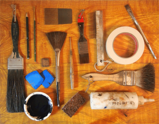

If you are going for oak I would suggest white, yellow and raw Sienna for background, raw Sienna and burnt (Turkey) umber for glaze, drag your grain then wipe your medullary rays.
and black. and raw umber. obviously. if your colour is looking a little bright, add a touch of either to your scumble.
I can mix colours in my head but a good cheat would be A. Find a colour image of oak you like. B. Try and find a close up timber image or photo a piece of oak IRL. C. Enlarge this in an editor and crop around i. The lighter background colour / medullary rays and ii. The darker striped grain.
Then simply mix two colours to match the blown up patches, easier to compare. Lighter colour is scumble background. Darker colour is graining scumble glaze. Just drag to 'add' grain, and wipe off for medullary rays. If you want to be posh you can experiment with wiping off for knots and apply a third very dark brown to form centre of knots / pips.

Which one? The wood finishing one was required reading at London College of Furniture. He's a bit of a ponce being an RCA graduate but it's worth it just for the apothecary section! The decorative painting one is also brilliant, the skill level is insane, again, just nice to look at the pictures!
Oh and yes! It's an very acquired skill, as I said, I thought I could do it! Not a chance. You need to use the proper materials as advised above, they make proprietary scumble glazes.
Try painting in your heart grain first. Then apply glaze around edges. Then use your dragger to create the fine grain wiggling as you go. Then flog. Then comb / use pin wheel to simulate grain. Then let set for a bit, then soften with your badger.
I wouldn't use a heel for oak as the heart grain figure isn't smooth, it's jagged, so you are better of freehanding it. Heels are good for simulating pine or other timbers that have smooth sided heart grain.
And unless you are artistic (I have painted since I could hold a brush) don't bother. You also need to study wood grain, like Da Vinci studied horses or human bodies. It's quite methodical once you get it. I was quite good at marbling but wood graining is much harder.
