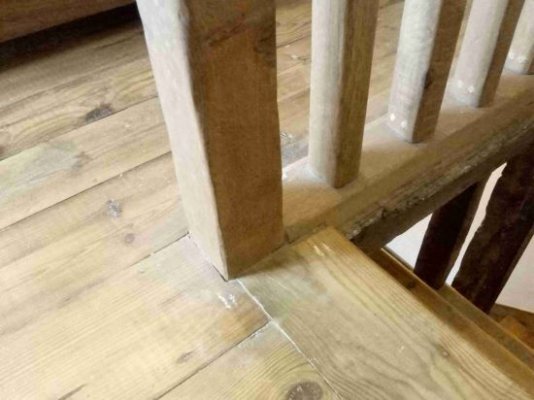

I have a handmade oak bannister in the bedroom, which is a bit wobbly. I used the normal modern method of securing bannisters (a hole up through the bottom and a nut which tightens through a hole in the side) and I guess what I was securing it to wasn't 100% flat, so it rocks a little from side to side.

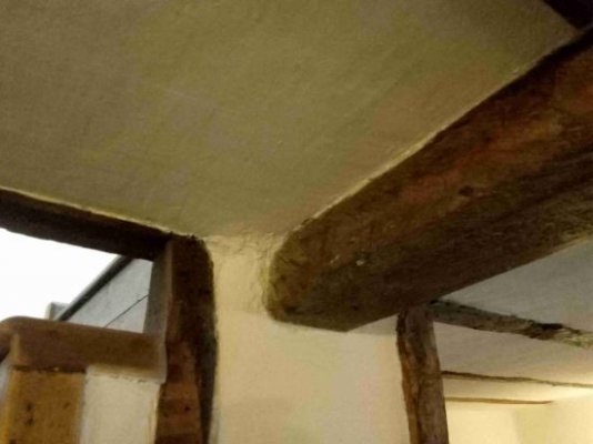

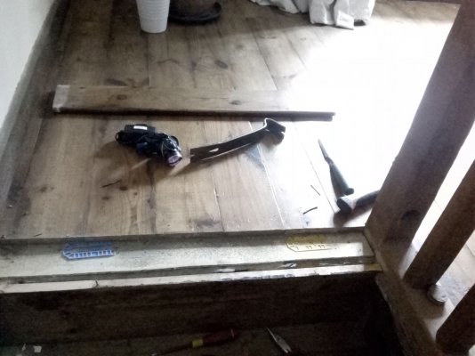

The bannister is directly above a main beam. I am thinking of drilling diagonally down through the bannister into the beam and inserting threaded rod which would bite into the timber of both. Presumably I wouldn't need to go more than a cm or two into the main beam, if the rod bites well. I don't think hardwood dowel would work, if it didn't adhere well to the beam then it would slide in and out of its hole and the bannister would still rock.
Here is the area from diametrically opposite viewpoints. The chalk marks on the top stair show where the beam is.

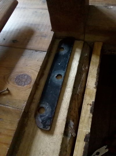

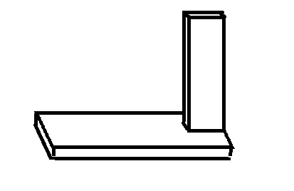

Any other ideas? A steel angle buried beneath the top stair is an idea, although beneath the top stair there is 6mm ply, then the original boards, before you get to the beam. Also then you'd have to cover the bit that sticks up.
