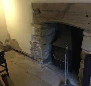

Hi, this is a call for help. What steps should I take to make this room dry and useable?
My family and I have recently moved into a house. The oldest section of the house seems to have damp issues a room we would like to use but currently don’t.
Pic of room
I initially noticed a damp smell in this room and that the plaster had blown away up to a foot from the floor. Also the electrics were tripping whenever something was plugged in. Since disconnected. In addition the previous occupants used the room to grow plants.

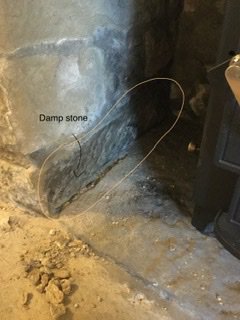

Always damp stone in chimney
Damp stone
Smelly room (has improved)
Blown plaster and render (cement plaster)
Rotten carpet fastener and carpet underlay close to walls

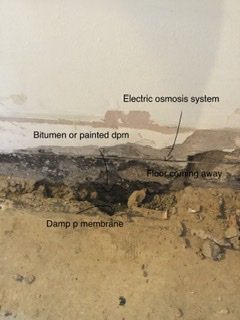

Poured concrete floor coming away near wall, exposing damp proof membrane (Does not reach wall) and liquid membrane painted upto first stone.
Floor and dpm
I have tinkered with the room, pulled up carpet and knocked off old plaster and render. I have also put in a constant source of heat in the room. The smell has really improved. It looks as if the exposed stones have lime mortar but have been capped with cement and pea sand mortar.
The internal damp stone seems to line up with a wet stone outside

Also the concrete floor and dpm does not go up to the wall about an inch short. It looks like the gap was painted with liquid dpm or some such and then filled with mortar.

Electric osmosis system throughout ground floor of house drilled into wall. Have been told this is useless. System came with the house.

The root cause of your dampness is the concrete floor plus the various damp proof attempts. Once water gets underneath it has nowhere to go until it gets to the walls at the edge. There is no great value in heating the place as the dampness simply absorbs the heat - as long as the base of the walls are damp the temperature will not improve much - all the calories you put into the air go towards converting water into water vapour (look up "latent heat of vaporization") instead of heating the room.
You say that the floor could be dug up. In my view that's the way to go, and you could lay a limecrete floor which would allow the water to dissipate. I did one in my kitchen/diner (20' x 12') almost ten years ago(!!!) and it has been great - the house is warm and dry. I assume that your French drain is lower than the floor level inside? If it is, and if you have sorted all other sources of dampness (primarily the roof, rain water goods, drains and chimney pointing/flaunching), then the limecrete floor should do the trick so long as you don't seal it or lay something non-breathable on it!

Where the new limecrete abuts the old concrete at the threshold just put in a bit of dpm sheet to prevent new bonding to old, then if/when you continue the limecrete project there will be no damage as the concrete is removed.
