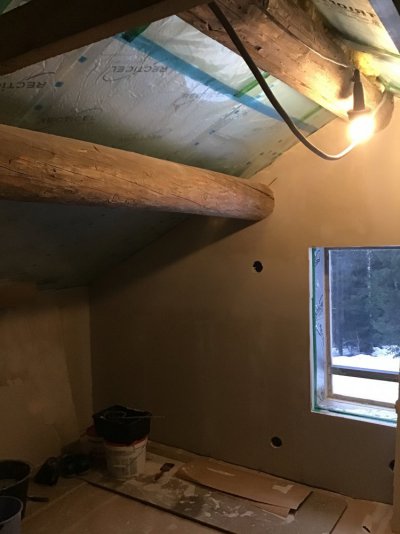

Well I'm a Brit but I live in an 1800s log cabin in central Sweden. I have insulated and dry lined the upstairs, I'm interested in using a lime plaster as a skim to retain an older aesthetic (everything is incredibly wonky here and the original purlins are still on display).

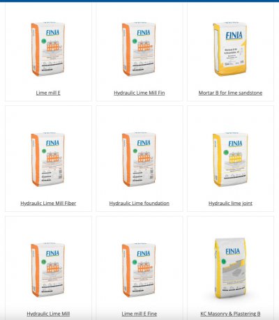

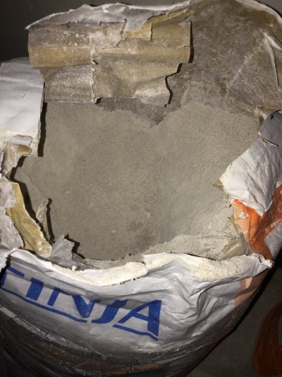

Pre mixed Lime putty does not seem to exist here. Ignoring any hydraulic lime products (although I'm a bit confused if I should be doing that?) I have access to 'lime plaster' and 'lime plaster fine' both of which are powdered (not putty) and without any fibre. I do have access to 'hydraulic lime plaster fibre' but as the name suggests it is hydraulic.

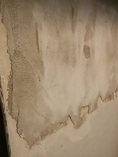

Anyway names aside I picked up a bag of the 'lime plaster fine' to experiment. I've never used any lime plasters before (only gypsum). The mix seemed quite dry. It wouldn't stick to the hawk at all, made a complete mess. I did manage to get some on the pb but it was really awkward as it wouldn't adhere and had to go on quite thick, and very patchy. I didn't hydrate the board, I didn't use PVA and the humidity here inside is very low over winter (20% sometimes lower). It has dried quite a bit overnight already but is very crumbly / sandy. Remember just a scrap of plasterbaord I was using.
