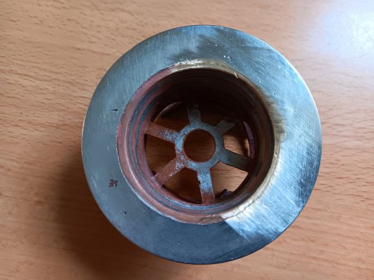

Hi All, I'm installing reclaimed sanitary ware in my bathroom and the taps will be brass. The sinks and bath currently have chrome plated plug holes, etc and I want to try to remove the chrome to reveal the brass underneath rather than replace with new brass fittings. I have tried soaking one plug hole in brick acid which had some effect (see photo). The right side is after soaking (looks like maybe copper layer under the chrome?) and the right side I used an abrasive metal disk on my drill, which revealed the brass under the copper but making a bit of a mess. But it hasn't really removed much of the chrome. Does anyone have any idea how to remove the chrome plate completely? Thanks!
