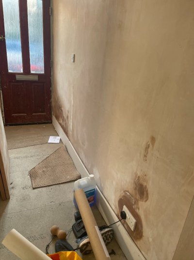

Our Victorian terraced property in Greenwich has a persistent damp problem all along our internal party wall which is giving us the runaround!
The pattern of water is a large bit of damp by the front door, then another bit in the middle, then another bit at the back of the house under our staircase - all on internal walls. It then crosses the threshold of the kitchen (which was added some time in 20th century). It seems to be worse after rain, but there is a permanent puddle under the floor.

Some pictures and map of affected ares are attached. The first image shows the damp area (became a puddle when we dug down a bit) which we discovered when we replaced the old suspended floors.

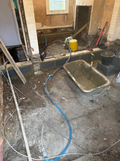

I have run out of ideas - my last remaining hypothesis is that there is an old rain overflow drain of some kind (??) underneath our house which is cracked and leaking. This explains the volume of water (puddles rather than damp patches under the suspended floor - see last photo), increased damp feeling after rain and the profile of the water cleanliness? Might this also explain the pattern of the water - running all along the wall in patches and then turning the corner? I am poised to get a CCTV drainage survey but keen to understand if this is a reasonable theory first!
