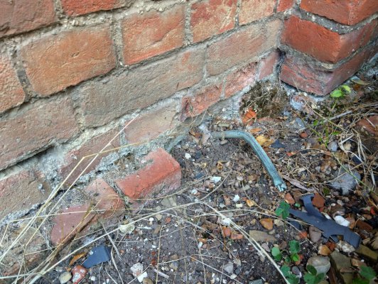

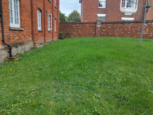

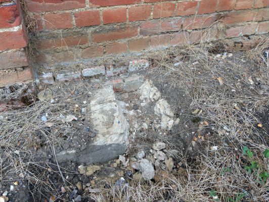

If anyone is curious, the issue with penetrating damp is due to the ground level outside being higher than inside by roughly 1-2 brick courses. The management company are installing a french drain and also installing an injected DPC internally at the floor level (I know injected DPCs are somewhat controversial, but being done internally in the mortar at ground level, I can't see what the harm is?). Picture below showing the high ground level, efflorescence, and deteriorated mortar:

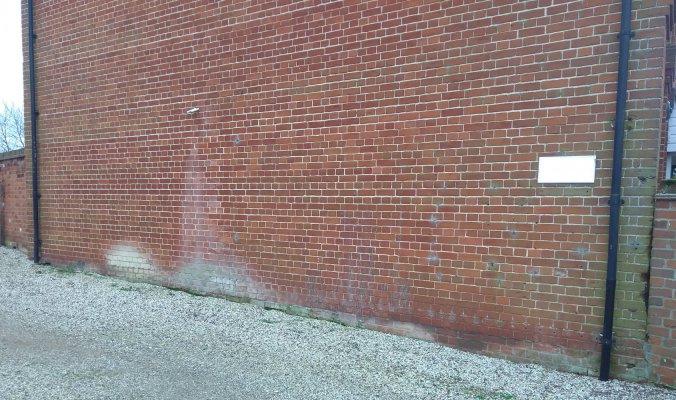

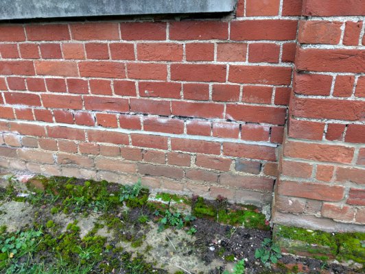

The other side of this corner is a north facing wall that doesn't get any sunlight. Again the ground level is too high on the left corner, and it looks like there's quite serious efflorescence under a pipe of some sort (no one seems to know what this pipe is for, and I've never seen it actually expelling water) plus damp bricks along the bottom. There are actually 3 DPCs on this wall if you look closely, which indicates to me that there have been persistent problems here, and the management company has just tried the same wrong solution at least 1-2 times ...

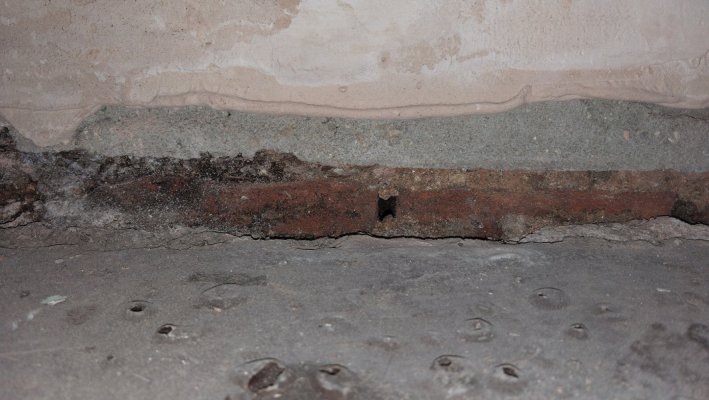

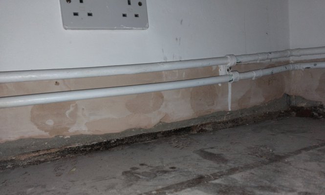

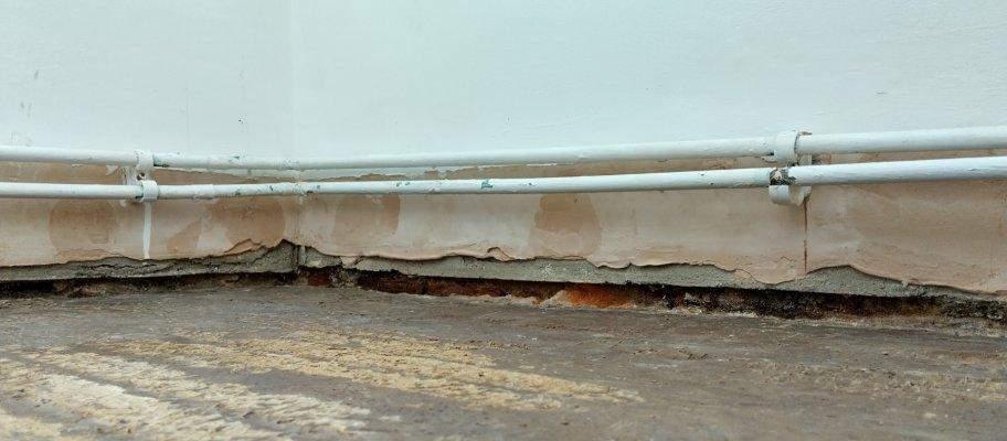

Internally the bricks are quite visibly damp at the base of the wall, but as the walls have been tanked internally with a cement render, it's difficult to know how far up the wall the dampness extends (although presumably as the exterior bricks don't look too bad, maybe not that far?)
