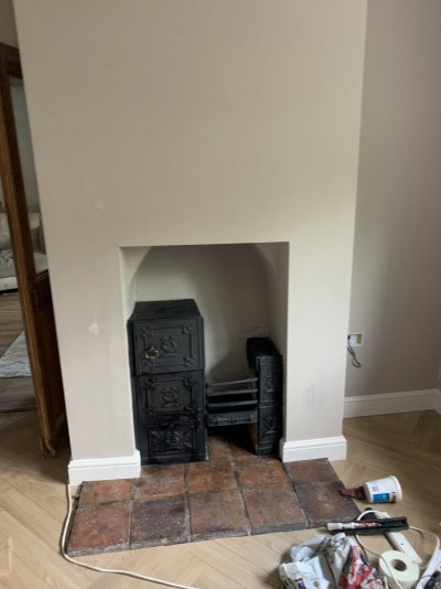

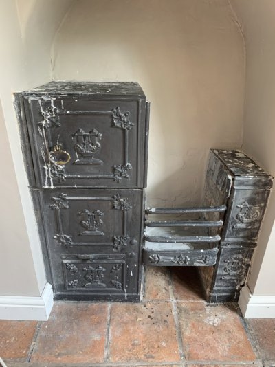

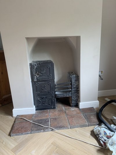

…and there was me instantly blaming the damn pigeons!!Assuming that is emulsion spilt on it, warm soapy water to clean and then stove black once it is all dry to restore the finish
Thank you. I will give that a goAssuming that is emulsion spilt on it, warm soapy water to clean and then stove black once it is all dry to restore the finish

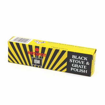

Hotspot Stove & Grate Polish - 75ml
A Matt black water-based polish. After drying, it can be polished to a rich dull black. Stove and Grate Polish will not smear or rub off on hands when dry. Apply sparingly.www.diy.com
Other vendors are of course available but weirdly B&Q is one of the cheapest
