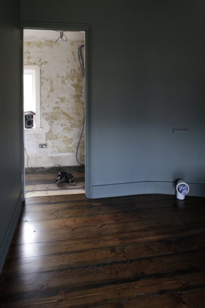

Thanks, I was aiming for something a bit rustic but as with all things I get carried away. The wood worm certainly gives it some rustic charm.Boards looks lovely.

This is what I found quite interesting, it suddenly appeared down the centre of the board as the detail started to come through.

Check out that chatoyancy... you can almost see some quarter grain figure, who said pine is dull?View attachment 12825

Thanks. There isn't many obvious sanding mistakes that have come through in the last week or so. I hand finished the final pass. I wondered if the mistakes may have been when I angled the Rotex to take off the higher points quicker but I don't think thats even true. I think next time I'll change up the pads more often, I was being a bit stingy and the sanding process probably took a lot longer than it should.Really fantastic work Paul, this is how your learn, often the hard way! Next time don't stain or coat unheated areas when its 12 degrees! So happy it wasn't fatal, just gave you a scare. Lovely work, I couldn't have done much better myself. And you ALWAYS can see sanding marks if you look close enough, nothing wrong with your sanding. You can be happy this result is better than 99% of sanding companies out there.
Yes, its looks almost 3 dimensional. I was pleased with the way the native and non native pine had a relatively constant tone and colour. I think the Bona Intense really helped with the chatoyancy, it gives a medium colouration.Check out that chatoyancy... you can almost see some quarter grain figure, who said pine is dull?
Depends what abrasive you used. Depends if you used the rotex in DA or orbital mode. Also remember the rotex has a 5mm throw. I finish with an ETSEC/3 with a 3mm throw. I also use a thin interface pad. Finally I water wash before the final sand. I can't really see any sanding errors though. You seem to have done a pretty good job.Thanks. There isn't many obvious sanding mistakes that have come through in the last week or so. I hand finished the final pass. I wondered if the mistakes may have been when I angled the Rotex to take off the higher points quicker but I don't think thats even true. I think next time I'll change up the pads more often, I was being a bit stingy and the sanding process probably took a lot longer than it should.
Bona intense is simply a pigmented water based primer, actually will dull the chatoyancy a bit! Shellac would of increased it. Chatoyancy increases the finer you sand, it means you did a good job sanding.Yes, its looks almost 3 dimensional. I was pleased with the way the native and non native pine had a relatively constant tone and colour. I think the Bona Intense really helped with the chatoyancy, it gives a medium colouration.
The grey is simply whatever reaction you got, as long as it doesn't delaminate you are fine, aesthetically it just looks interesting, possibly even aged more. No stain is lightfast. I always thought nitrostain had poor lightfastness but I only really ever used it as a contract polisher. Water dyes have better lightfastness as do the lightfast spirit stains I use in my shellac tints, but any warm stain will go cooler after a few years. Shutters are a good idea if you want to prolong the colour. Lecol is great, again, next time make sure area is heated and apply a thin coat of shellac after the stain, it should help. Floors shouldn't change so much after you have finished! I guess it's fun to see what happens.I've noticed a few of the Lecol infills have changed the last week, they've gone a kind of off white / light grey but looks fine. I won't be using lecol much more for the rest of the house, just needed it for the bathroom. I have know doubt the floor will keep changing, especially in the summer when it really drys out. I must sort some plantation shutters, there were some good deals on this Easter weekend. I'm aware Nitrostain isn't entirely light fast in direct sunlight.
Ok, I'll do some testing with the shellec and the Jenkins nitrostain before I do the bedroom.Bona intense is simply a pigmented water based primer, actually will dull the chatoyancy a bit! Shellac would of increased it. Chatoyancy increases the finer you sand, it means you did a good job sanding.
