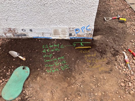

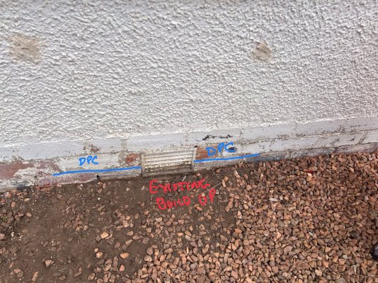

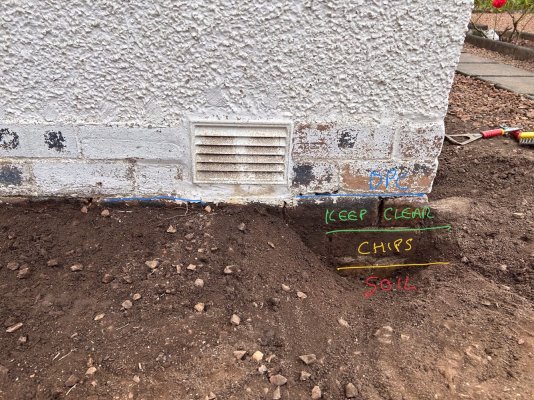

Looking to ask for some advice please.
Externally, previous owners have simply continued to top up red chippings, such that ground level is close to dpc and airbricks. I’m wanting to address to prevent any possible future damp issues. Was thinking to take ground leave to two brick below dpc and the fill tone brick below dpc with chippings - some photos hopefully attached.
However, wider garden at higher level and not able to take this reduced height idea very far. So was thinking of taking out about 300mm from building and installing kerbstone idea to deal with different levels, but was concerned this could create a channel canal that might cause problems in heavy rainfall. Any suggestions most welcome. Thanks
