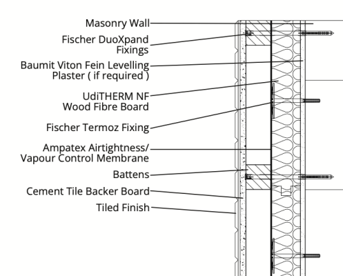

And the worst damp / high ground level area will again be the bathroom, and will be mostly tiled. The suggestion with the system is to omit the internal layer of Steicoflex. So the build-up would be:
Ie tiles on tilebacker board - not very breathable….
