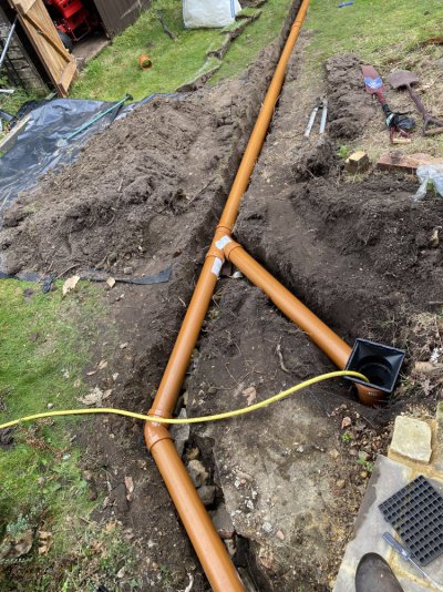

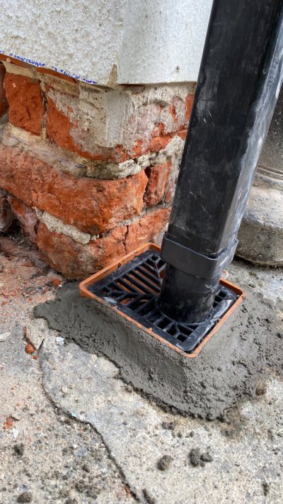

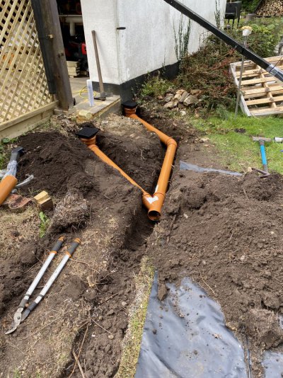

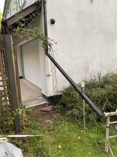

Inevitably there were significant damp problems, investigation of rainwater goods rapidly revealed a complete lack of soakaways, or even pipe work actually connected to anything. Along the way I started to question how the surveyor had established the lack of DPC given the external cement render going all the way down to the ground, but the previous owners had been conned into the inevitable silicon injection treatment which had then been implemented above the level of the floorboards

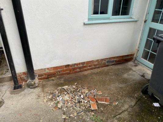

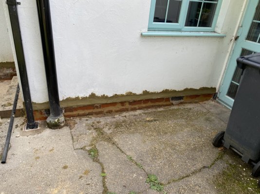

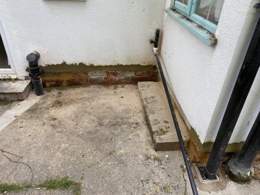

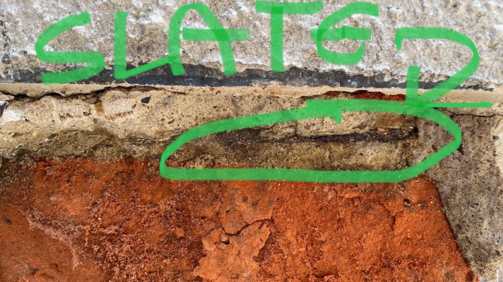

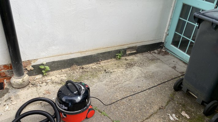

So today I set about reconnecting what pipework did exist, and cutting back the render - only to reveal, shock of horrors, a slate DPC!

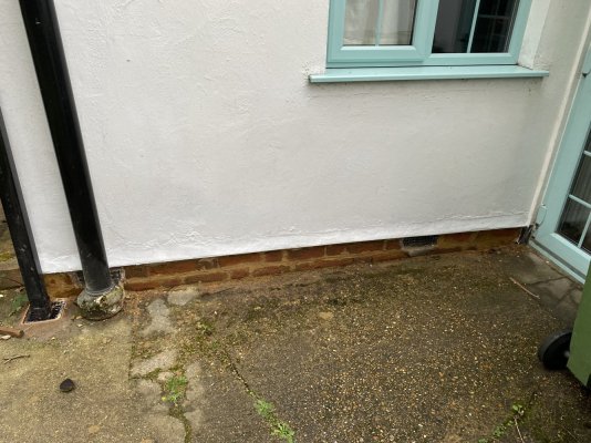

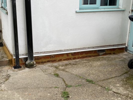

So, a perfectly well constructed house damaged by damp for years due to an incorrectly diagnosed cement render bridging the DPC and defunct rainwater management
Now in the process of cutting the render back above the DPC and putting in a bellmouth as I can’t face hacking off the whole lot, making good the damaged soft reds below the DPC and getting a proper rainwater management system in place!
