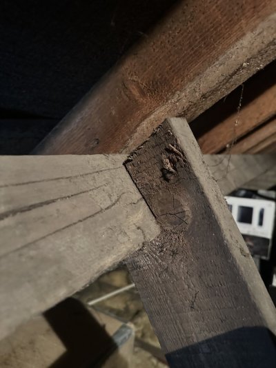

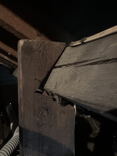

The previous owner has also butchered the support beams in the loft, no-one picked this up before but looks like some have been cut back or removed to support the work he did below in the bathroom / bedroom. Not obvious until he pointed it out.
