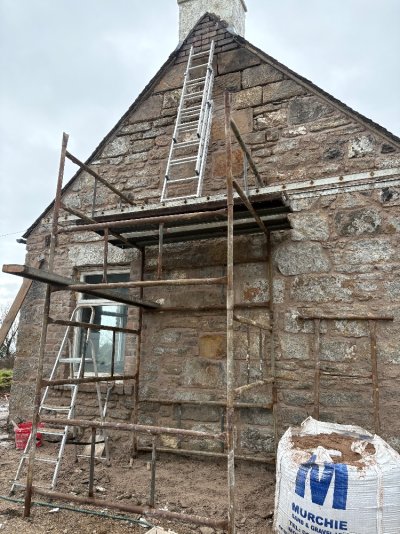

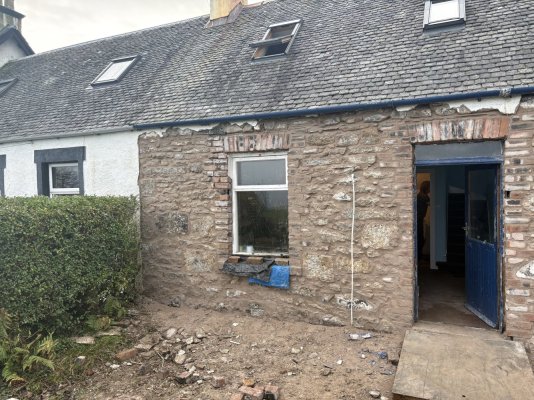

just finished repointing the cottage - we have had very mild weather up here in Scotland, and the pointing has already started to go off. At the end of next week temperatures are going to drop to below zero. Do I need to wrap the cottage in hessian after the pointing has already had about 10 days of curing ? Will the dry outer skin protect the internal (possibly still wet ) render ?Thanks!
