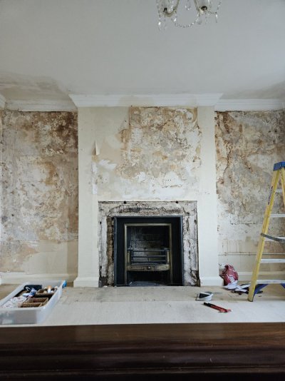

Hi all, having replaced the cement render with a lime render on exterior of our home, we are now moving to interior, starting with master bedroom which had major damp and staining from a since repaired chimney.
Attached is recommendation from our contractor. The walls already have a lime render which need some repair, she suggested a lime putty. I was confused over whether this would provide a smooth finished look and we queried about lime pigment. Reading since on this group about mixed experiences of limewash on interior rooms, was hoping people could share experiences, advice etc.
If pigmented lime isn't ideal, think I am happy to just go for a white finish.
How about staining? All other experiences very welcome - starting to doubt this will ever come back to a decent finish.
See attached photos of room and proposed works.
