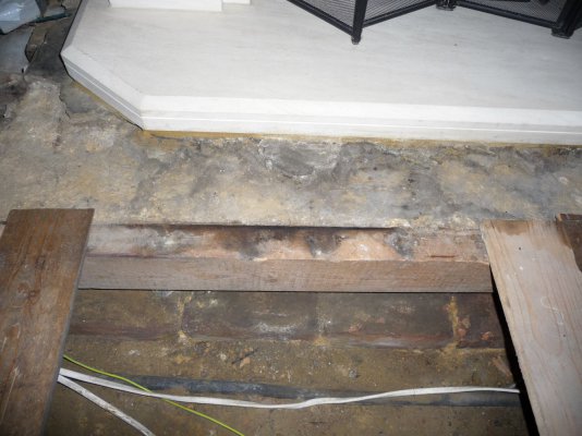

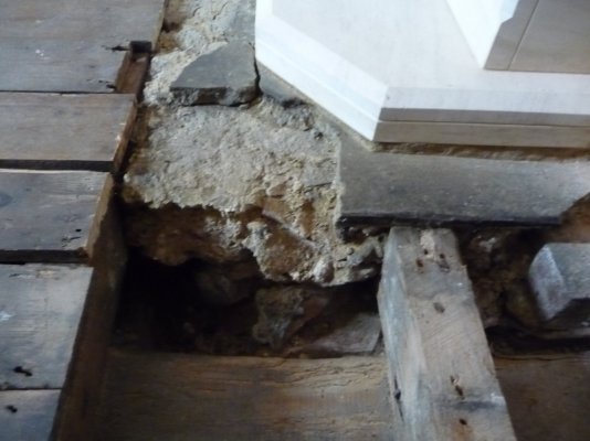

Well, over the last few days I have been monitoring things-always monitoring and losing the will to live-. The joist I showed in the pic sometimes gets almost totally dry and then attracts the damp in the same patterns if there is more moisture in the air. I really am trying to control humidity and I find the Thermo Pro hydrometer good for this. Have not used moisture meter yet-although they have been used by any 'expert' who's been. BUT, I decided to put a piece of newspaper amongst the rubbly lower hearth for a few days and have just looked at it and it is wet, not soaking, but wet. This suggests the constructional hearth is wet somewhere. This is why I thought I needed to investigate properly by having it dug and restructured as one surveyor said. I do think like you-if it ain't broke don't fix etc, but if I get the floor all sorted and coverings put down etc-wouldn't be months yet! and then have issues I'll never forgive myself. It could be because the water from my neighbour's leak has penetrated it and it hasn't dried properly yet but it could take forever!!Monica,
If you are convinced the room is not getting wetter there is no good reason to consider removing your fire surround. The hearth will dry out on its own without any interference or intercession from anyone - if it aint broke dont fix it. The humidity changes you are seeing are likely a direct result of heating and ventilation indoors and is precisely the right think and exactly what you need. As far as measures of timber dryness is concerned anything below 20% is good. Based on what I can see there is no need for new joists or re-construction of your hearth and therefore no reason to think about damp proofing these.

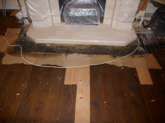

What can you tell us about how the hearth is constructed? Is it a solid mass or constructed of bricks and mortar?
May be an idea to clear away all the loose debris lying on the surface and then lay a newspaper, all of it, down to repeat your test. Newspaper is so porous it will attract moisture very quickly and if the hearth is very wet the rear pages should be soaking within a few hours at most.

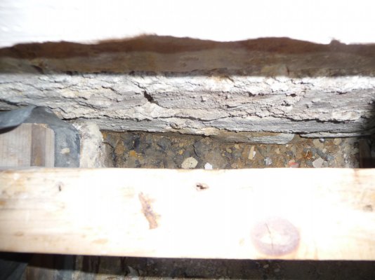

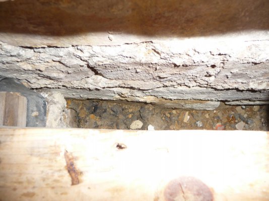

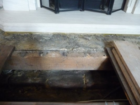

Hi Steve, Thanks for this, but the thing is if I put my hand in any gap amongst the rubbly underpart there is slight damp-eg I can manage this in a gap shown in the second pic. Also I think I can remember there were red tiles under that fire surround before it was installed-possibly part of the original fireplace that must have been there long before my time. I don't think they were taken up and they are porous aren't they? Those joists still dampen up when humidity is high as in last few days which I worry about but will eventually have them replaced I think- treated ones won't have this problem I feel.Hi Monica,
Well, that's good news at last as it seems that your damp problem has been solved and you should now be able to put the floor back to rights without tearing out the fireplace. It is not unusual to find that hearths are constructed of building waste and mortar, any scrapped bricks and other non combustible detritus would be chucked in there to allow the use of an open fire. There are several possibilities concerning the thin black layer of material under the decorative fire surround but its most likely a self-levelling floor compound that was installed before the more modern fireplace/surround was installed. You will need to think through how you intend to proceed after re-fitting the floorboards. Let us know if you have any concerns regarding how to proceed.

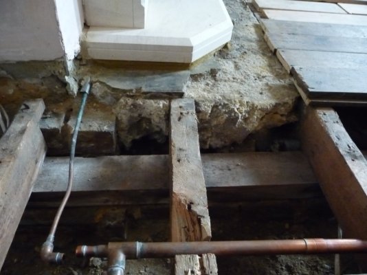

Your hearth was undoubtedly built directly over the earth and has no damp course per se. Consequently it will continue to absorb moisture from the ground and, while much of the excess water absorbed from the leaks you have had has now evaporated off it will never be genuinely bone dry. This is entirely natural and to be expected with older houses and is managed through the use of breathable materials in ints original construction and future maintenance. Given the various proofs of your success in remedying the leaks and driving out excess moisture I think that it is safe to start getting the house back in order and re-laying the floors.
Theres no need to worry about any old tiles that may have been left in the hearth. They will behave just like any other building waste in its structure and will do no harm. You need not be concerned by the timbers feeling a little damp at times, the wood is much more porous than other materials and will leach moisture from the atmosphere whenever humidity in the room is high. This too is part of the natural breathing of the building and can be considered a healthy sign.

Sorry for confusing you, 'fall' refers to the slope needed in a drain/pipe to ensure that water flows in the right direction toward an exit or soak-away. Given the mass of that hearth, and added to the fact that its set directly on the earth below, it could take years to thoroughly dry out. Particularly if the local water table is high or during/after long periods of heavy rain. Frankly its a tough call to make as to whether the hearth and fireplace should be completely removed and to some extent it must be based on what makes you feel most comfortable. Should you decide to do so, it may be possible to remove the fireplace without damaging it and re-install it later should you choose to keep it.
Bluntly, I'm impressed by your patience, mine would have been exhausted long ago and I would probably have taken drastic measures sooner - but then I'm not known for my forbearance. Don't be too quick to replace the joists though if they are showing good signs of drying out and there's no softness or collapse of the fibres present. A good woodworm killer/inhibitor treatment may be all that's needed.

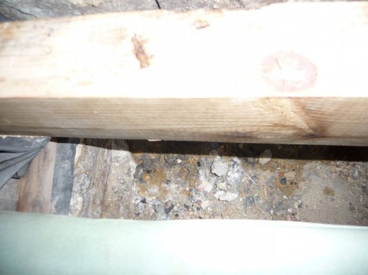

- Depending on how severe the original leaks next door were and how long it was before they were discovered and repaired a huge amount of water may have been absorbed into the hearth and the ground below. The only escape routes for that water will have been either by spreading out through the earth to the outer walls or through evaporation through the atmosphere of the room concerned. Given where we are in the year, how wet the weather has been and the possibility that water trapped against the exterior walls may be finding its way indoors, then what you are finding in the void may simply be the result of that new water finding its way along lines of least resistance.
- Its something to keep an eye on but unless you can find a specific source of water entering this void its likely that it will be something that will cure itself when the hearth and the ground below it throughly dry out.
