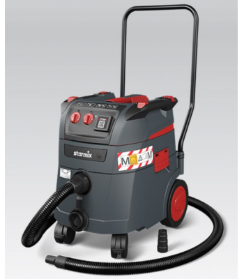

The CTM26 and CTM36 both have an automatic vacuum shock type auto clean function and can be used with open bags and the HP filters. These can be used to vacuum plaster and fine dusts. I still think the Starmix ipulse system is more efficient but at least the 26 and 36 models actually can be used with plaster.
