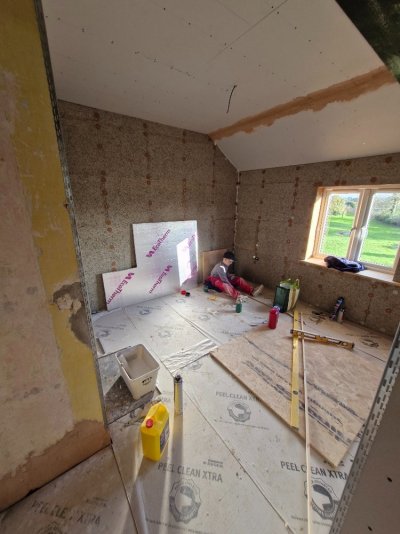

We're nearly finished with our renovation project, all internal walls have been skimmed with gypsum and all exterior walls have been built up to wood wool ( red brick > rough lime coat > 60mm woodfibre bats > vapour control layer > wood wool) .
I'm now looking to get the last walls plastered and I'm getting mixed messages in how to finish.
I've had some friends use BreathAplasta Universal Bio-Based Plaster in 2 passes with a 5mm mesh in the first pass. This seems the most simple method that my plasterers will probably prefer.
Mike Wye recommended an Isovit lime in 2 stages with a mesh lightly imbedded in the first pass after applying with a notch trowel, then a finish coat with a Reabilita Cal AC FINO lime coat.
Maybe its a case of 6 of one and half a dozen of the other but it would be great to hear what others have used and if they were happy with the results or if they have any tips.
