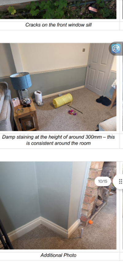

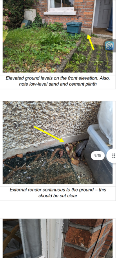

We moved into a Victorian terraced house, which has a poured concrete floor instead of it's original timber floor. There was no sign of damp when we moved in, so we didn't think too much about this, although our level 3 survey did say that we should lower the ground level. We then had what looked like rising damp, and had a damp survey completed which says we need to remove skirting and cut back plaster to stop bridging. We're fairly confident we can do this ourselves (we have no DIY experience at all but it seems simple).
We aren't sure whether we have a DPC as the surveyor couldn't tell due to this concrete at the front.

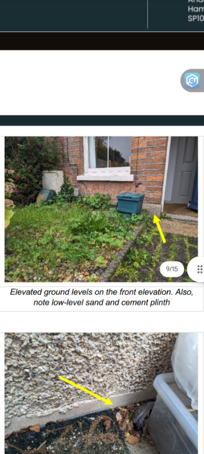

Our main issue is how to go about lowering the ground level at the front and back of the house. What time of tradesperson would be able to do this, to make sure they do it to the right level to reduce damp but also not damage the structure of the house?
And, would you also remove the concrete at the front and back of house?
