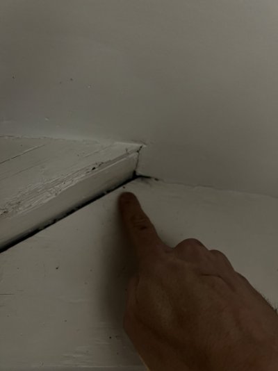

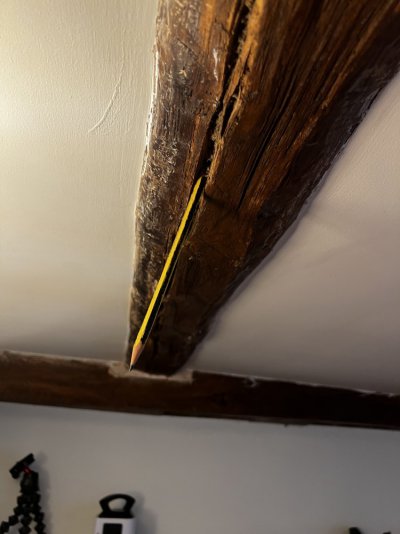

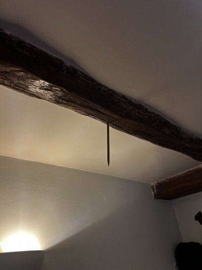

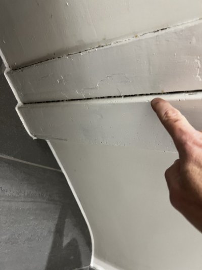

That implies that the gaps have opened in both the interior and exterior seams where the plaster or render typically meets the timbers of the frame. In the worst cases driven rain can be forced through these gaps Fromm outdoors to do considerable damage to the interior. Externally you will need to use either oakum or caulking cotton hammered into the seam and the seam finally closed with a fillet of lime mortar. It's not wise to use oakum internally as some of its oil content will bleed into both the plaster and wood of the timber to produce unsightly stains. Caulking cotton or stranded sheeps-wool (if you can get it) should be used internally and the final closure achieved with a lime based filler.
It's vital that you closely examine ALL the exterior seams between the infill panels and the frame. Driven rainwater can track quite amazing distances along and down the frame members to appear indoors later or worse, become trapped in the mortice and tenon joints near the foot/cill/sole plates of the frame to produce huge damage later. You need to get on a ladder and get cracking before the weather turns later this year. Good luck.
