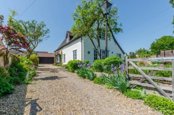

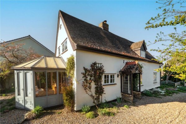

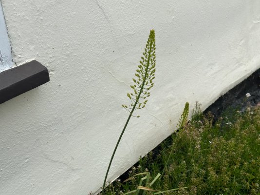

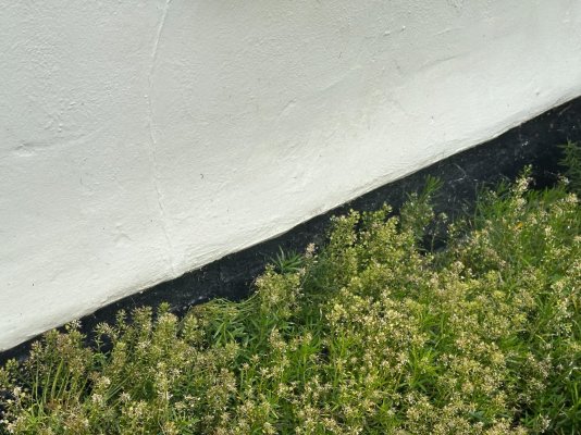

I asked for photos of the cracks, and honestly, to me they are barely visible. I've attached those along with a couple of general exterior shots. My husband is ready to walk away based on this, but I’m more on the fence. I understand that cement render on a timber frame isn't ideal and would eventually need replacing, but given the lack of damp and other visible issues, I’m surprised by the urgency and scale of the recommendation.
