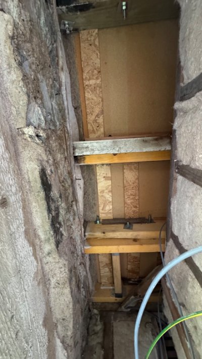

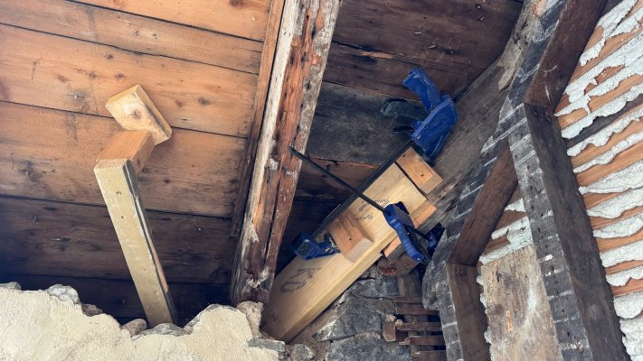

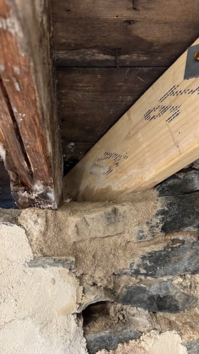

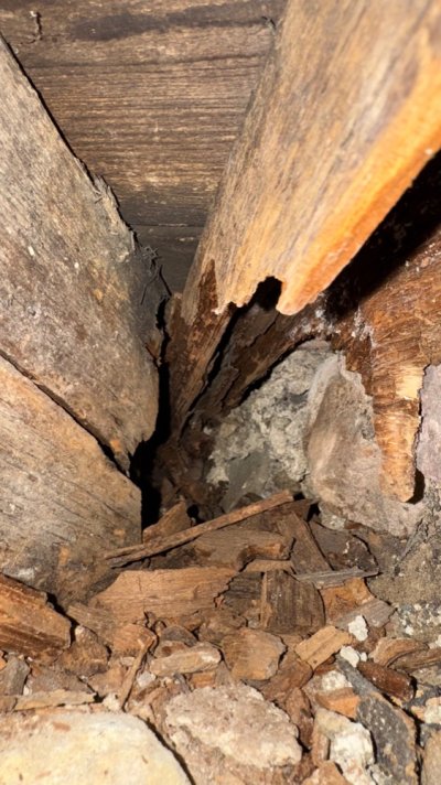

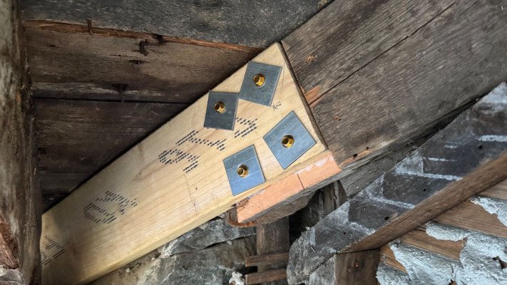

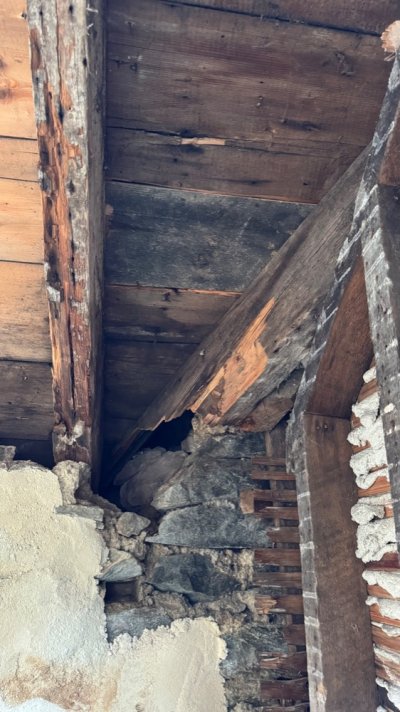

Which is when problems came to light. Several of the joist ends were barely hanging on and with the ceiling stripped you could see the backs of the sarking boards just above the wall head were soaking. I thought this must be due to a badly detailed overflow pipe for the old cistern in the loft but with that deleted and slated over it was still wet. Then I happened to spot a flash of light between the sarking boards coming from below the valley gutter. Closer examination revealed a pin hole in the valley that was allowing water to soak in. I believe that over time this took out the joist ends and also the front door lintel below. All completely hidden from view, possibly going on for decades. That's all been fixed (almost, see later).

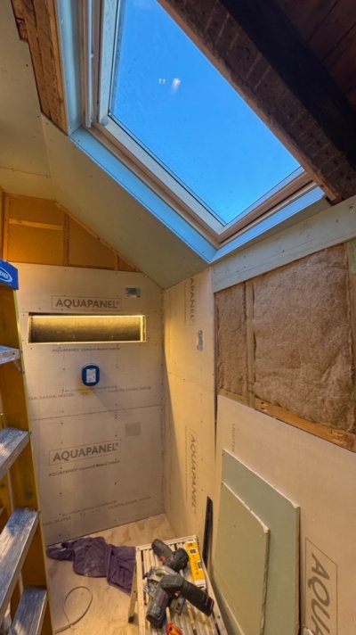

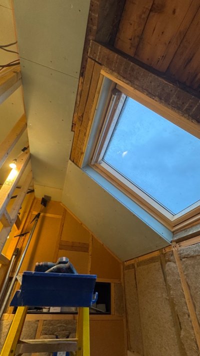

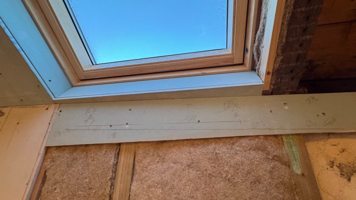

I've trimmed and insulated with hemp around the newly fitted Velux. Can no longer feel any air movement around the window frame, good.
One of my little obsessions.. As I overhaul each window I add concealed alarm contacts. At first I couldn't figure out how I was going to do this because either the case or the sash have those very technical looking grey mouldings on them, but they can just be unscrewed to reveal the case. Still have to put a magnet on the sash. Obviously its pretty unlikely anyone is going to break in through a roof light but the contact can be useful for automation things like turning off the heating if the window is left open or sending a notification to remember to close it.

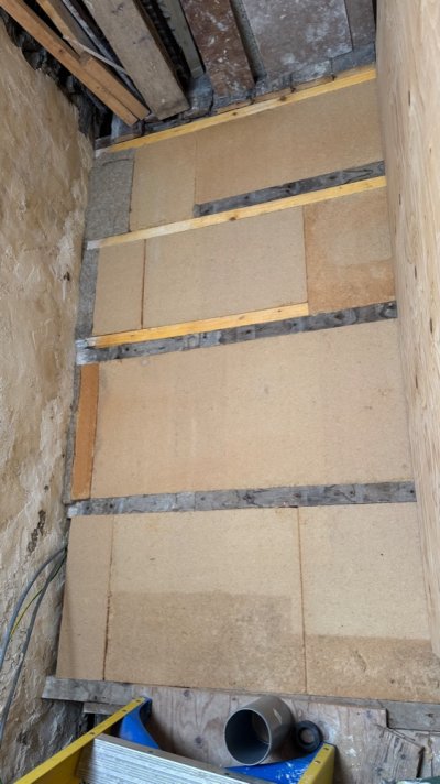

I carried the parge coat all the way down between the joists to the wall plate in the first bay. The intention is that the wall insulation will extend down to below the underfloor insulation to give a continuous layer. The front door vestibule is below here so the floor needs to be made very airtight and well insulated.
