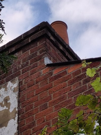

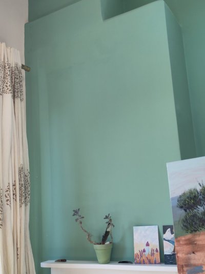

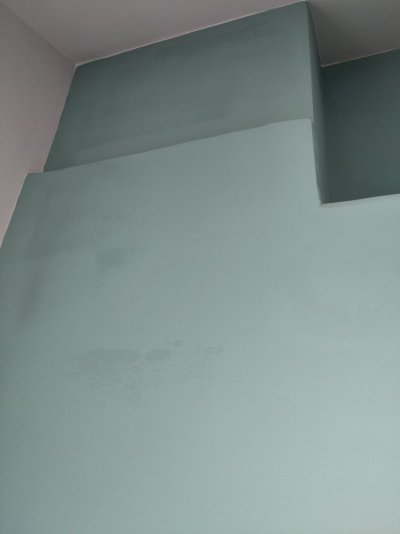

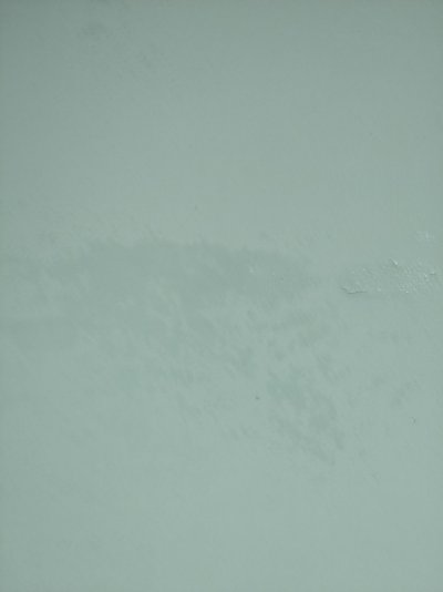

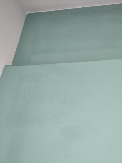

I have recently had a room decorated in my old Victorian terrace house, where there is a chimney breast. The wall covering the chimney breast was previously covered with old lining paper so I was not aware of any damp issues. A few weeks after decorating during some cold and rainy weather, some damp patches appeared in the new paint in the chimney breast area. These patches disappear or reduce quite quickly as soon as the weather warms up.
After some reading around I am pretty sure that this is related to hygroscopic salts in the brick/plaster attracting moisture from the atmosphere. My question is, how to address this? I know there is the nuclear option, hack off the plaster and take some of the brickwork out and fix up, redecorate, but thats really not an appealing option if I can avoid it!
Also, I have seen some suggestions elsewhere that this kind of thing might be related to lack of ventilation in the chimney - would that be relevant as well? My chimney is not ventilated I believe, or capped. The damp patches seem surface level only and dry out quite quickly, I would have thought that if moisture inside the chimney was being drawn out through the bricks to the room (which is what I assume ventilation for the chimney would relate to) that the damp would be a lot more pervasive and slow to dry out, but I am a novice so not sure.
Anyway, would any of these solutions help?
