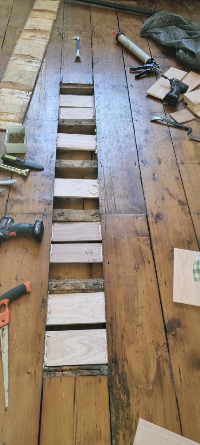

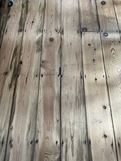

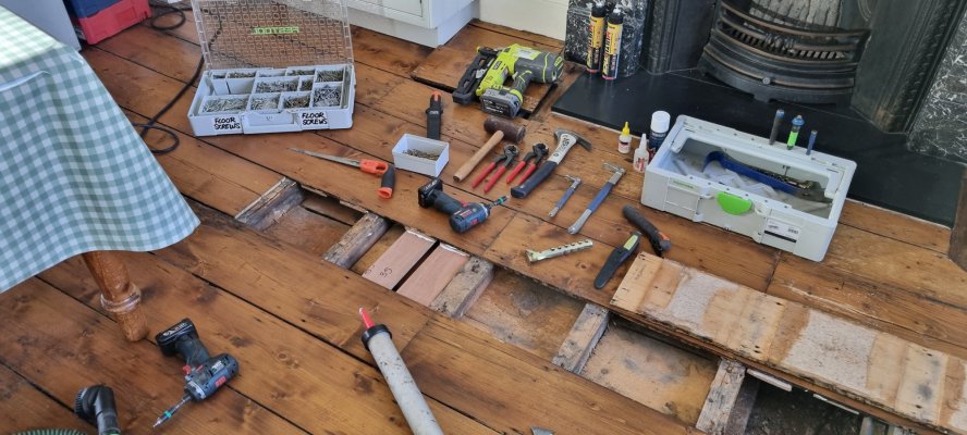

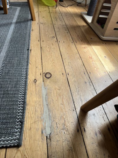

In about 3 weeks I will be lifting up all the existing pine floorboards in order to add insulation between the joists (using the system devised by ecological building systems). So this is a great opportunity to restore & repair the existing pine flooring which is looking rather crap. Photos don't do it the misjustice it deserves.
My initial plan was to run all the lengths through a thicknesser/planer. BUT, I lifted 2 boards this week and measured their thickness, they are only 15mm (ish). If I was to plane or sand these it would make them even thinner. In fact, if I put all my weight on some boards they flex in between the joists.
