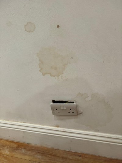

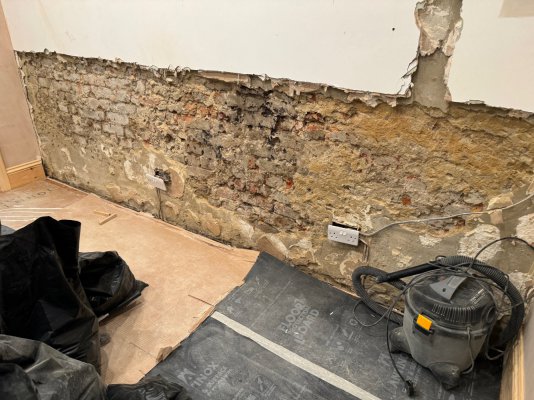

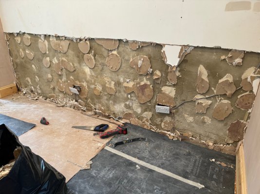

Hello,
We live in a late Victorian terrace in London and are finally tackling damp issues that exist on the internal walls on one side of our house - in the living room and back room. And its the back room we're currently a bit stuck with!
We have a lime plasterer lined up, and in the back room agreed with him to take the bottom of the wall back to brick up to 1m. We are doing the hacking off ourselves to save a little money.
We expected the back room wall to be similar to our living room chimney breast and alcove walls that we've already taken back to brick... where the bottom third was cement render, middle third was plasterboard dot and dabbed on brick, and the top third the original lime plaster with a gypsum skim over the top (yes a really weird mixed bag!)
However, it looks like the back wall has been rendered with cement bottom to top (possibly over old plaster?) and then had plasterboard dot and dabbed over it. I sent a picture to our plasterer, who eventually replied saying wait a few days to see if the cement dries out - but we'd already started taking it back to brick by the time we got his reply, thinking we need to help the bottom of the wall breathe.
I guess my question is - what now?
I'm also thinking we'll also need to clean the exposed brick and try to neutralise the salts? As there used to be a chimney breast in the back room that was taken out a long time ago?
- Do we have to take all the wall back to brick and lime plaster it all?
- Could we take the dot and dabbed plasterboard off rest of wall, but leave top half as cement render? And plaster over it with something else?
- The top half of the cement render appears to be in sound condition (no darker patches or efflorescence from the test patch we removed further up)
- But would it cause issues having part of the wall lime plastered and part as cement render skimmed with something else?
