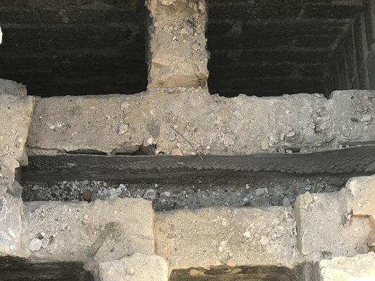

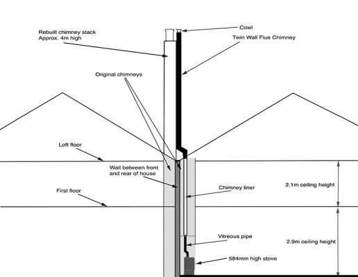

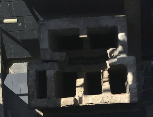

It probably is worth putting a bit of flashing on top of the old render edge so that water doesn't get behind the concrete render and push it off. If the render edge looks a bit odd being straight cut all the way around then cut it a constant level above the roof line and use stepped flashing on the falls to hide the sins.
If it were me I would rebuild the chimney with 3.5 lime mortar and bed the pots in a beautuful cement flaunching which goes slightly past the edge of the decorative chimney top.
Don't use any sort of damp course - the bricks laid in lime will be happy evaporating water away and will help the courses of bricks underneath stay dry too. Wet is a bad thing for lime as the soft upper courses demonstrate. Cement render and a badly maintained capping did that.
Not sure about crack filling in cement. Cement will crack again. Maybe something flexible. PU sealer springs to mind. It's a bodge but cenent was a bodge in the first place.
