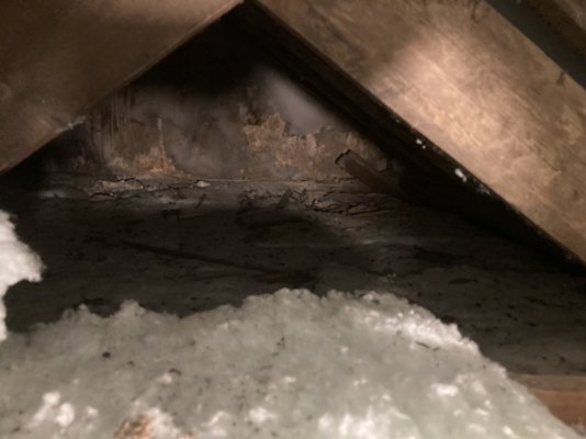

....Going back to the matter of smoke appearing in your loft space - part of the gable wall of your loft is also the rear wall of the chimney breast in your neighbours house and if the mortar pointing was in a poor condition this would explain the source of the smoke. If that pointing was not properly repaired at the time or was perhaps merely coated with a layer of render then this might provide a path via which rainwater entering the chimney could find its way to your wall below.
If you can find no obvious faults in the masonry in the loft space you have little choice but to get on with your internal repairs and hope that the root problem has been resolved.
