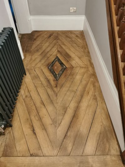

Yeah soft pine has a tendency to go orange, its the hardest wood to stain according to Toby.This was almost my downfall in the hallway. I got a load of testers (Morrell's I think), tried them out on a spare piece of floorboard and decided on the one that seemed to best match the doors.
After applying a couple of coats of it across the whole floor it was veering too much towards orange for my liking. Saved by a couple of coats of shellac sealer which brought it back to the more honey-like colour I was aiming for.
Unless you have years of experience doing it, I think its really difficult to tell how it will turn out until you are well committed. The thought of having to start over was just too dreadful to contemplate. Sorry Matt, not helping with your procrastination...
For the next room I may skip the stain and just do extra coats of shellac. The challenge with that one is going to be the 4 or 5 rows of replaced boards that are much whiter than the original boards.
I went all round the houses when searching for a stain, I had a small stock of original boards to make samples from but soon ran out and had to re-sand the samples I didn't like to make more samples. Absolutely none of the products matched their swatch, especially looking online on a computer screen. Some of the colours / stains were dreadful imho. I ended up opting for a Jenkins 'old school' Nitrostain. Once dry the details in the wood are mind blowing, the individual knots go flame orange /red and looking through a magnifying glass you'll still never comprehend all the intricate lines.
