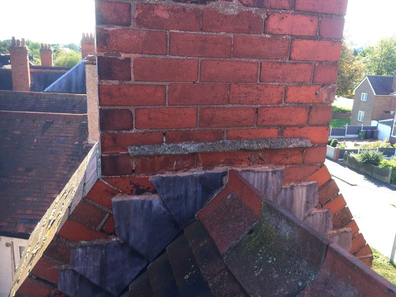

On the inside face of the chimney, above the roofline, there's a slight projection from the brickwork - looks like slate - that someone has put a fillet of mortar on - looks like it was meant to throw drips away from the face of the brickwork. Has anyone come across this before, is it likely to be a slate DPC that extends all the way through the chimney? Nothing visible from the other side. Here's a picture, taken from my study roof window, unfortunately I'll need scaffolding to get at it up close:-
As you can see the projecting slate looks like it has a bit snapped off at each end. The flashing to the roof should be good - it's only about 12 years old, and I can get directly to the underside of that section, all looks dry, no sign of leaks.

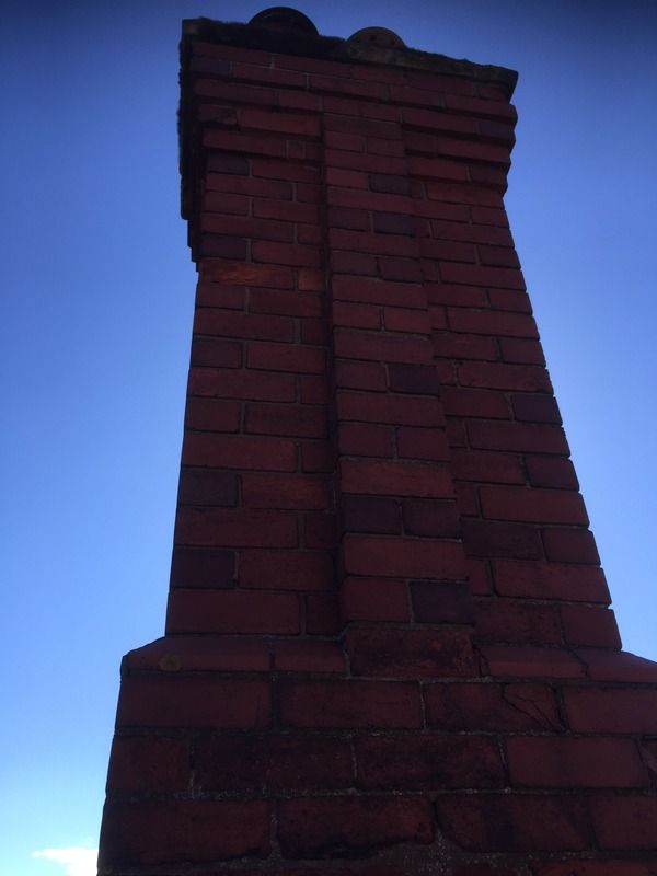

I've always been a bit suspicious of the 2 sloping side sections of brickwork, if they are likely to let water in. I've thought about screwing some treated battens to them and putting roof tiles on them - overhanging the edges by a couple of inches, with flashing into the brickwork above. This is the rest of the chimney above:-
I don't know what the top of the chimney is like, but the roofers I had when the roof was recovered did check the flaunching and reported all was OK. No reason not to trust them but it was 14 years ago I suppose, it could have failed since.
